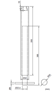

*I designed a ball launcher with rubber bands on both sides like a drawing on the left, but later I changed my design to the right because I wanted to make it easier to hold it.*

Then cut the materials into the right sizes (see the first picture for the measurements).
Drill a hole for the handle to fit in, then cut the top of the PVC pipe for rubber bands (I used a band saw, but you can use a differnt saw to cut it).
