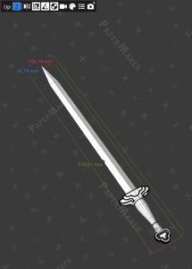

I designed a 3D model of the sword as close as possible to the design seen in the film with several references and frames of it.
Then, on the Paper Maker page, I converted it into printable templates for assembly.
