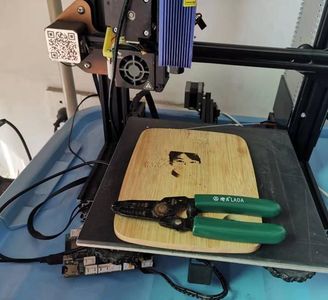

Introduction: Run Laser CNC,Grbl_ESP32,Ender3 Printer
Laser CNC with Grbl ESP32 which based on the board PandaZHU/M4 Can support 8 motors.

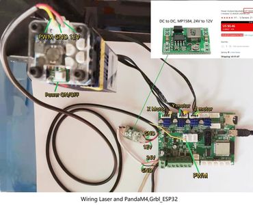

Step 2: Wiring

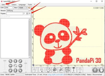

Step 3: Laser Cut With PC
  1. Download and install LaserGBL from https://lasergrbl.com/
  2. Connect to board
  3. Open and choose one picture which you want to cut
  4. Click Run button
