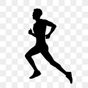

Lets design fancy clock with the help of inkscape. I have attached the image of running man which we will use to design our clock. First convert this image to object.
  1. Load image into inkscape software. Now, select the image and and go to path--> trace bitmap option.
  2. New window will pop up. Select brightness cutoff and check the live preview. Now change the value until you get the desired result. This process will give you black and white(bitmap) image. It is nothing but thresholding in image processing. Once you are done click OK.
  3. Now delete the original image and keep the bitmap image. Now select eraser tool for right hand side toolbar menu and remove the head. We will draw new head.
  4. Select circle option from right hand side toolbar, and draw big circle at position of head. Now we have two objects one without head and one circle. Now select both these objects and goto path-->combine. select combine. Now we have running man with big head as one object.
  5. For laser cutting we need only outline. So select the object and goto object-->fill and strokes. First click on fill option and select no fill. Second, click on stroke paint option and select flat color. Third click on stroke style and kepp width as 0.1 mm. You have the outline now.
  6. Lets draw numbers. Select text option from right hand side toolbar. click on workspace to type text. Now type number and select font, style and size. Now move your number to appropriate position. Do this step 11 times for remaining numbers.
  7. Now its time to outline the numbers. Follow step number 5 for outline.

Its time print some fancy and unique hands for the clock. I am going to attach only two hands (hour and minute hand). As the theme for this clock is running man, lets design hands of same theme. First convert the image to dxf and then use that dxf file in Fusion360 software to make it 3d.
  1. Open the silhouette image in inkscape software. We have to split it in two parts, upper body and lower body. First convert it to bitmap image. Follow the previous steps to convert it to bitmap.
  2. Then, use rectangle tool from right hand side, and draw rectangle from half to bottom. Now select rectangle and bitmap image and goto path-->difference and selct difference. Now you have the upper body. Now save this upper body as a dxf file.
  3. Do the same step for lower body. save it as a dxf.
  4. To 3d print it, lets use fusion360. Open fusion360 and create new project. Now create new sketch and use insert dxf feature and add dxf files of upper body and lower body. Scale it according to clock dimensions. Now add circles of 5mm so that we can fix these parts on clock.
  5. Once the sketch is ready, extrude it by 1.4mm. Save the 3d objects as stl files and print it.
  6. After printing, attach the upper body as a hour hand and lower body as a minute hand. Our running man reverse clock is ready!!
