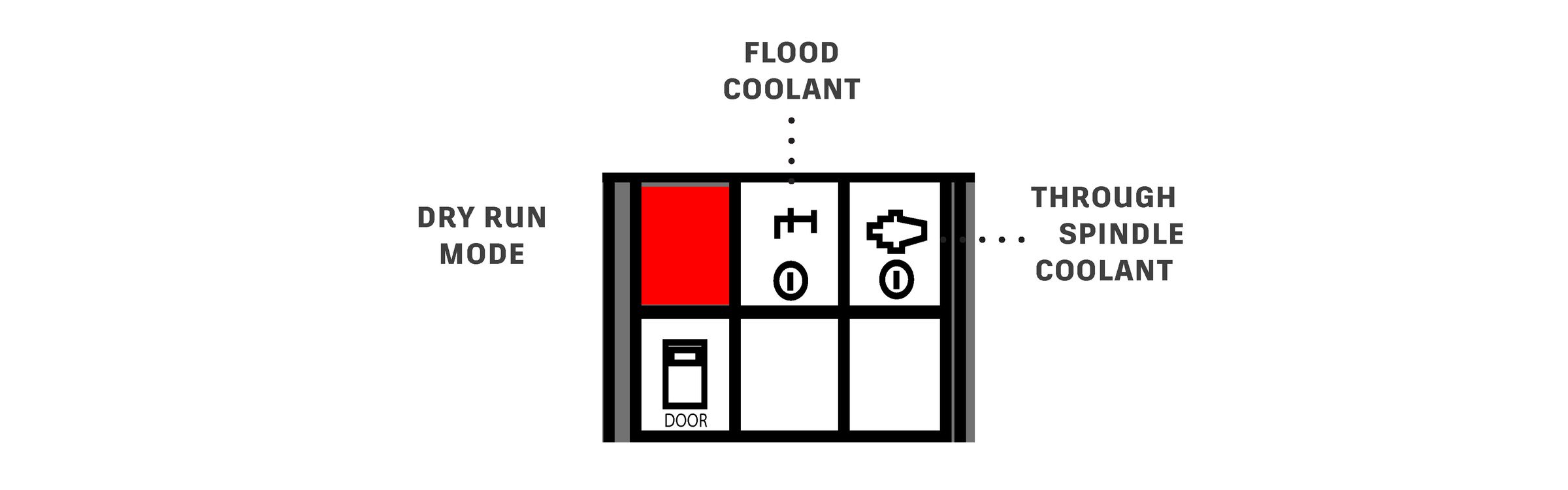

Using coolant
Because of the spindle's high speed and feed rate, coolant is required.
- Flood coolant will automatically be turned on after every tool change.
- To disable flood coolant for a dry run, use dry run mode (red button).
- Toggle flood coolant on and off to increase visibility while tool is descending in Z.
- Use through spindle coolant for deep pockets and holes.
