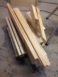

Step 1: Cut and Mill
The wood that I got from the yard had defects and warps, so I had to mill it. I just bought a used Jointer off Craigslist, and this was my chance to try it out. I cut the pieces 4-5" longer than needed to account for snipe. Once milled, I cut the pieces to length.

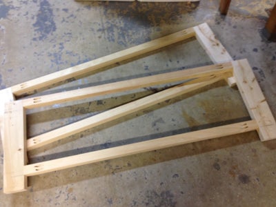

Step 2: Drill Holes and Assemble
Pretty much what it says in the title.

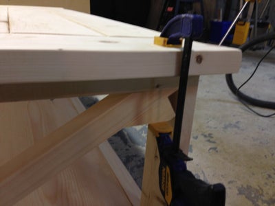

Step 3: Connect the Cross Beams
Pete screwed in the cross beams, I decided it would be easier to glue them. The angles on the joins make it difficult to clamp the beams. To fix that, I cut small blocks at 60 degrees and used them to brace the clamps. See above.
