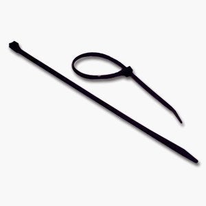

- Wire Strippers
- 3 zip ties
- 4 soderless female spades

Step 41: Step 5.5: Attach Kick Board to Frame
Place your kick board against the frame where you want it to go.
Mark with a pencil the hole you need to make to for your zip ties.
Drill the wholes.
Attach the board to the frame with the zip ties.
Snip off any extra slack on the zip ties.
