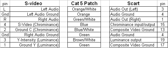

S Video is a higher quality signal than using phono connections and Scart is a very convenient connection as it combines all the connections in the one socket.
The Scart diagram included is the break out side to the TV. Scart input is wired differently and is really easy to search for in the usual ways.
I have decided to just go for the s-video connection at the moment but I include the pin outs for the Scart if you feel adventuress.
You will also notice that I show a jack but i actually used red and white phono with a phono/jack adaptor on the pc end

step 1:- Connect the wires to the RJ45 terminal. solder each terminal. I found it easier to work from the back row and move away from me that way the soldering iron didn't burn any of the connections I had already made.
I have a very small vice that I use for holding items I could really do with another hand though he he. I also find that a good light source can be invaluable. in the second picture the glare has made the desk look blue. you can also see on the desk an old ADSL filter that I had not thought of using at the time but I will come to that later.

I used an old ADSL Filter box to make the connection on the TV side. On my TV the connection on the side is used for the playstation, the wii and now the PC. So I felt that I needed to make a robust terminal for the job.
Step 1:- I used a bit of double sided foam tape to stick the RJ45 terminal in the box. I originally tried to connect the terminals in the same way as I had on the PC end but I found that working in the box was too tight so I stripped a bit of network cable and soldered it to the RJ45 terminal.
Step 2:- I then cut a bit of strip board and attached my jump leads on the one side and my AV cables on the other side
