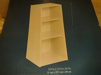

Step 1: Assemble the Box Housing
This step is pretty easy, just make sure your box is the size you want. The hardest part for me was actually simply finding the box I wanted to use. Everything seemed to be the wrong dimensions, I was lucky I thought of the idea when I was staring at this shelf that wasn't the right depth. I decided I was going to turn the shelves sideways and it would work because the back would be the interior for wiring. Then I figured out that the shelves wouldn't work, so I went back out to buy a piece of wood to fit in the center. Make sure the light bulbs fit entirely inside the box before locating the divider. There's also going to be a lot of extra parts.
