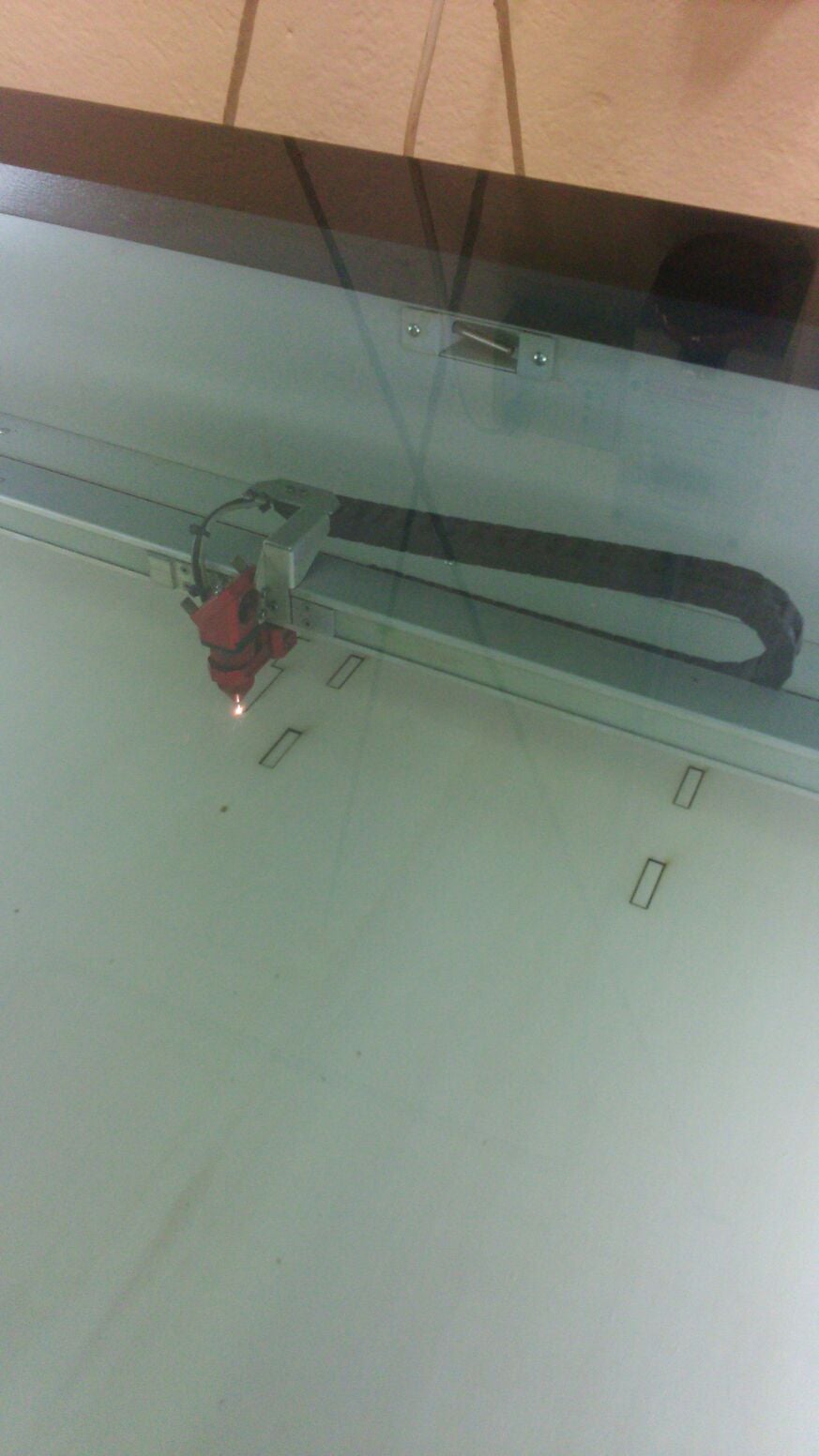

Step 3: Cut the Structure
In this step you have to cutting the box with a lasercut machine.
You have two vector files, with this set up the material:
2 sheets of plywood 8 mm
