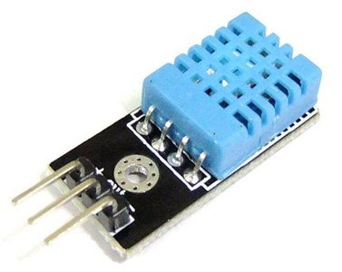

Step 1: Read DHT11 Sensor
The DHT11 is a basic, ultra-low-cost digital temperature and humidity sensor. It uses a capacitive humidity sensor and a thermistor to measure the surrounding air and spits out a digital signal on the data pin (no analog input pins needed). It's fairly simple to use but requires careful timing to grab data.
The process of reading DHT11 can be done using Arduino, in this project a microcontroller is used. This sensor module is classified as a resistive element such as a temperature measuring device such as an NTC. The advantages of this sensor module compared to other sensor modules are in terms of the quality of reading sensing data, which is more responsive, which has speed in terms of sensing temperature and humidity objects, and the data that is read is not easily interfered with. DHT11 sensor readings can use the program on the GitHub link in the attachment or on the following link. The reading results are as follows.

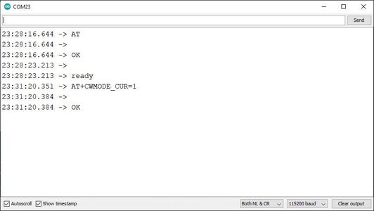

Step 2: Test WizFi360-EVB-Mini Connection
WizFi360-EVB-Mini is a compact development board for experiment, testing, and verification of WizFi360. WizFi360-EVB-Mini is the same form factor as the NodeMCU V2. WizFi360 is a low-cost and low-power consumption industrial-grade WiFi module. It is compatible with IEEE802.11 b/g/n standard and supports SoftAP, Station, and SoftAP+Station modes. The serial port baud rate can be up to 2Mbps, which can meet the requirement of various applications.
A brief AT command describes for operating of WizFi360 as TCP Client in single connection mode. If you need AT command example of another mode, see the documentation called "AT command examples". For more information you can check on this official documentation. In this project, a serial monitor on Arduino is used to test the WizFi360-EVB-Mini connection. Experimental results can be seen in the image below.
