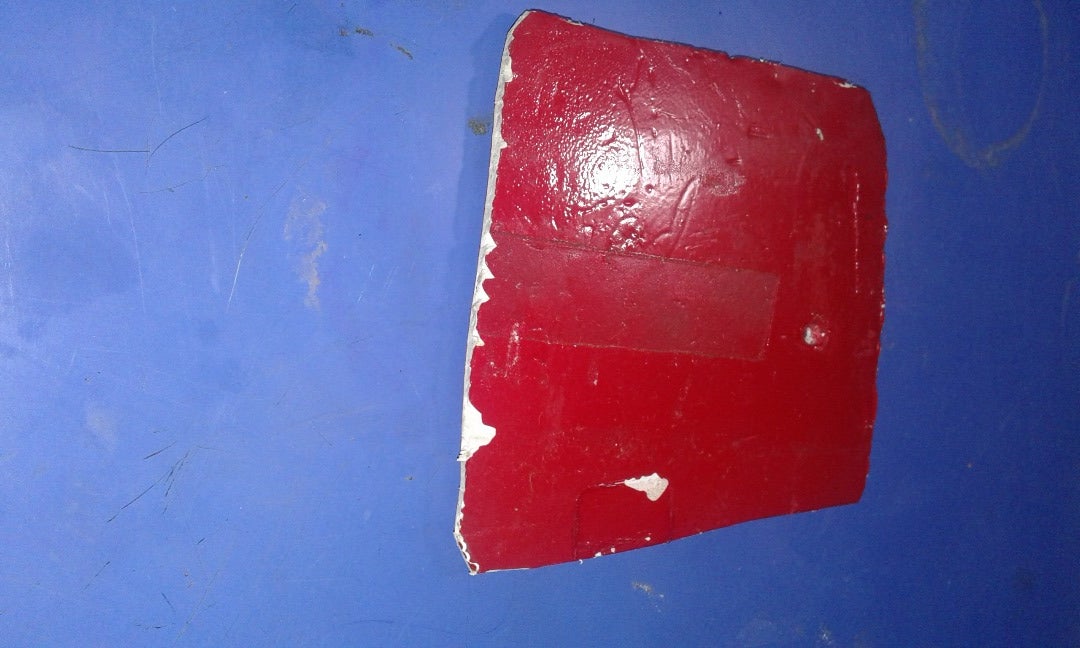

Attach wheels to motors
Attach micro controller to bread board
Attach motors and castor wheels to the ply
Attach bread board and battery to ply (NO PIC SORRY GUYS . HOPE U CAN MANAGE . U GOT A BRAIN !!!)

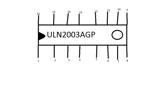

NOW ATTACH THE WIRES AS FOLLOW
( for first timers , see the schematic diagram fro reference of pins )
JOIN THE NEGATIVE PART OF THE SENSORS AND BATTERY TO THE 8TH PIN
JOIN THE POSITIVE PART OF SENSORS AND MOTORS AND BATTERY TO THE 9TH PIN
JOIN THE NEGATIVE PART OF THE LEFT MOTOR TO THE 16TH PIN
AND THAT OF THE RIGHT MOTOR TO 15TH PIN
JOIN THE OUTPUT OF THE LEFT SENSOR TO 1ST PIN AND THAT OF RIGHT SENSOR TO 2ND PIN .
