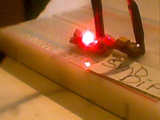

Step 3: Solder First Side
Now solder one side of the SMD part, this is difficult, because its a very small component.
How do I do it:
I add first a little bit solder to the circuit board, the i lay the component on the solder, and heat it shortly until the solder went liquid.
sofortly when the SMD component stick into the solder i remove the coil and wait until the solder is fixed.
You dont need to do it like this, may you have better techniques then me.
!!! Dont burn yourself, the SMD component gets hot VERY fast !!!
!!! dont heat too mutch, the SMD part may get destroyed !!!
Step 4: Solder Seccond Side!
This is mutch easier, you can use now the "third hand", because the SMD part is now fixed to the circuit board.
Just attach the circuit board to the "third hand" and solder the seccond side
!!! also here dont heat too mutch, the SMD part can break or the other solder gets liquid again !!!
