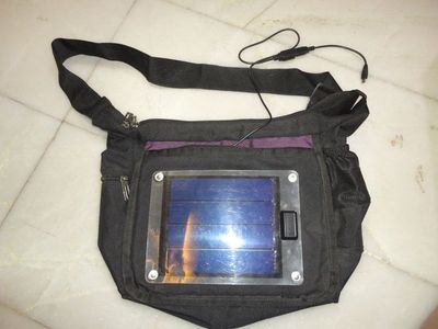

Step 1: Step 1: ASSEMBLING SOLAR PANEL

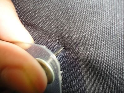

FIRST TAPE THE WIRE COMING FROM THE SOLAR PANEL TO THE MIDDLE OF ITS BODY AS YOU CAN SEE THE PICTURE.
PUT THE SOLAR PANEL ON THE FRONT SIDE OF THE BAG AND MARK THE HOLES WHICH WOULD BE SUITABLE FOR THE RIVETS TO ENTER AFTER MARKING BOUNDARY HOLES CREATE A BIG HOLE IN THE MIDDLE OF THE BAG FOR THE OUTLET OF WIRE COMING FROM THE SOLAR PANEL ( REMEMBER WE JUST HAVE TO TEAR THE UPPER CLOTH ON THE BAG FROM CENTER,AND REMOVE THE FORM FROM THAT AREA SO THAT WE CAN GET THE SOLAR OUTPUT WIRE IN THE BAGS POCKET). AFTER TAKING OUT THE WIRE RIVET THE JOINTS FROM THE ALL 4 SIDES AND HERE YOUR SOLAR PANEL ASSEMBLY GETS OVER.

NOW WHEN WE ARE READY FOR THE TRIP WE CAN CARRY THIS BAG WITH US AND IT WILL CONVERT SOLAR ENERGY IN TO ELECTRICAL ENERGY AND SAVE IT IN POWER BANK .
WHEN OUR ( PHONE ,CAMERA,I POD, BLUETOOTH ,ETC ) ARE NOT ENOUGH CHARGE SO AT THAT TIME WE CAN MAKE USE OF IT. WHILE TRAVELING AT NIGHT PASSING THROUGH THE DARK ROAD WE CAN UTILIZE OUR BAG TORCH WHICH EMITS ENOUGH LIGHT TO MAKE OUR PATH CLEAR. NOW WE CAN ENJOY OUR TRIP WITH OUR HOME MADE SOLAR BAG. IF WE PLACE THE BAG DIRECTLY IN SUNLIGHT FOR 2.5 HOURS THAN IT CAN CHARGE OUR 100% PHONE BATTERY .
