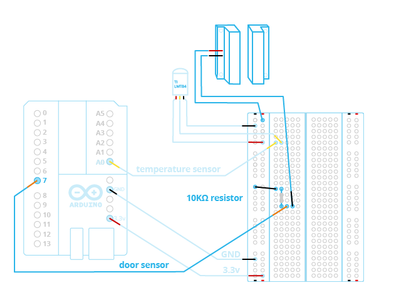

Step 2: Connecting the Hardware
Step 1: Hooking Up Power
Connect the Arduino’s GND pin to the breadboard’s ground bus strip. Connect the 3.3v pin to the voltage supply bus strip.
Step 2: Connecting the Temperature Sensor
Connect the left leg of the TI LMT84 to voltage, and the right leg to ground. Next, connect the middle leg to the analog A0 pin.
Step 3: Connecting the Door Sensor
On the breadboard, connect one leg of the door sensor to digital pin 7 through a 10KΩ resistor. Connect the other leg of the door sensor to ground.
