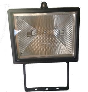

Step 1: LUMINÁRIA PARA LAMPADA DE 150 a 200W HALOGENA - SUPPORT Halogen Lamp
Suporte luminária para lampada Halogena de 150 ou 200W
Suport to Lamp Halogen 150/200W

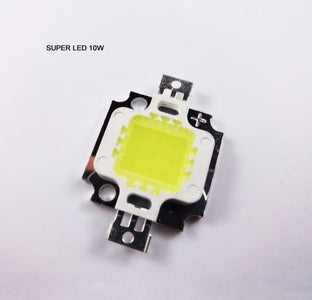

Step 2: SUPER LED 10W = 150/200W 6500K COLD BRIGTH
Use LED SUPER 10W 6500K
Warning: use SINK it´s very importante
Step 3: DISASSEMBLE SUPORT LAMP - DESMONTAR LUMINÁRIA
Step 4: DISASSEMBLE SUPORTE TO ADAPT LED
DISASSEMBLE suporto to receive LED inside
Desmontagem da luminária para adaptação do LED internamente

    aluminum

    What did you use for a heat sink?

    Reply 4 years ago
    I used sink and a resistor to limit the voltage

    Reply 4 years ago
    aluminum, atach picture
