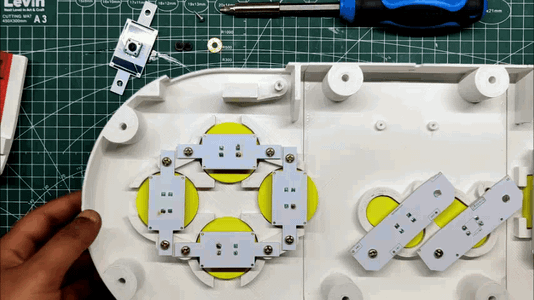

Threaded inserts of the M3 size are used to mount PCBs on the 3D printed body.
These inserts are placed into holes that are added to the 3D part. They serve to facilitate the insertion of bolts or screws and make it easy to remove them for reuse at a later time.
To position the Switch PCBs, we needed to employ a total of twenty threaded inserts; each board will have two inserts mounted on it, and the DPad has four threaded inserts for mounting.
Using a tweezer, we first choose the insert and position it in the 3D body's hole.
Next, we heat the insert with a soldering iron set to a temperature of 150°C. Once heated, the insert fits into the hole when the plastic in front of it melts.
It thus slides into place, and after we take out the soldering iron, it cools down and is fixed there permanently.
Step 11: D PAD BUTTON ASSEMBLY
  • Prior to assembling the buttons, we mount the DPad button in its designated location and attach the DPad PCB to the rear of the 3D buttons.
  • Next, we permanently fasten the PCB in place using four M3 bolts.
  • We verify whether or not the button press is smooth.
Step 12: XYAB BUTTONS ASSEMBLY
  • The round buttons were then placed on the base body in the ABXY position, and the Switch single-board PCB was positioned on the back of the buttons.
  • Following the installation of eight M3 bolts to secure every PCB in place, we tested the buttons to see if they were functioning correctly.
