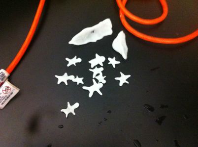

Step 3: Make the Boat and Passengers
Take the neodymium magnet or magnetic bead, and mold the polymorph boat around it. Don't make it too thin or the magnet won't hold. Make it thick enough so it fits in the coil you made.
You can see in this photo I've started with an attempt to make a standard boat with a flat end. This isn't ideal, as it turns out. You need a round bottom for the boat to fit into the coil, so I gave it a more rounded end. Also, you'll see I started making a little person shapes. These are meant to be the game pieces, and stand in for players. One player, one person. So if it's a three-person game, three pieces. This is a bit tricky because the pieces are small and may not fit on the boat, or tip it over.
Again, to make the boat, put the neodymium magnets in the base. This will keep it balanced when put on the coil.
