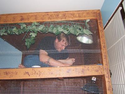

The snakes are in a pen that I built several years ago. The enclosure is a 4' x 4' x 4' cube on top of a 2' x 4' x 4' base. The enclosure is divided into two stories to house the two snakes and was expertly painted by my wife. I don't put them together at all because I don't want any baby snakes.
Originally, two 60 or 75 watt reptile bulbs are what I used to provide the heat and light. So for 12 hours a day, I'm using 120 watts for the lights.

The lights were replaced and I put mesh over the front of the dome lights so the snakes can't somehow break the CFL's. The lights are controlled by a light timer set to a 12 hour on/12 hour off cycle.
I tested the heat cable and rheostat on my kitchen counter to get the heating temperature correct. Then, I ran the heat cable into the pen and fastened it into place with some duct tape. I coiled the heat cable under the area where the light shines and placed a piece of rubber matting over it for safety. I duct-taped the mat down so it wouldn't move.
The rheostat was mounted to the side of the pen with all the other controls and both heat cable were plugged it. The rheostat is controlled by a second light timer on a 18 hour on/6 hour off cycle.
