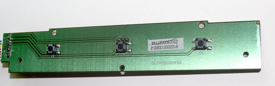

Mini-boards are found in a wide range of electronic products. You can spot a likely candidate by looking for a highly sculptural case that has several distinct areas filled with buttons and other controls.
- Small boom-box radios are a likely source of mini-boards. If the radio has buttons and dials sticking out at different angles, one group on each side and a center console - then it's a good bet there are several small boards inside.
- Home printer/copiers are also a good source. If your printer/copier has multiple keypads and controls on separate parts of the front face, there is a good chance it also has multiple boards inside.

The best boards are the simplest boards - a few buttons and switches that are easy to re-purpose for your projects. It is tempting to salvage the large boards with 20 buttons, 10 potentiometers and lots of LEDs. I have done that, but I've never really used them after I reverse engineered them. I just don't need all those inputs for my projects. They make great training exercises, so go ahead and try to decode a huge board - just don't be surprised if you don't actually use them very often.
But I do use the simple 4 button boards all the time. They are convenient and simple. And if I need more inputs, I simply hook up a second, equally simple board.

Hopefully, you are somewhat familiar with basic electronics. While still simple, reverse engineering commercial electronics is actually a bit more complicated than following the step-by-step instructions in hobby kits. You might run into some odd items and techniques not found in kits designed for beginners. At the very least you will need to know how to use a multi-meter to trace down circuits and how to tie your circuits into existing circuits.
A good first step is identifying where the power comes into the board. From there you can begin tracking where the electricity is distributed and how it's controlled. Attach one of your multi-meter's probes to the power line, then pick another line and press buttons until the reading changes. You now know what button controls that line - simple right...
Often the power and all the return lines are grouped into one bundle. Other times the power and returns are in two or more groups. Simple, button-only boards may not have a dedicated ground line - all the grounds will got through the buttons. More complex boards, with potentiometers and encoders especially, will have a dedicated ground wire that always carries current. Some boards even have two power lines on two separate circuits, say a 5v and 12v circuit - all on the same board.
Yes, this can get complicated, but it is a great way to learn real-world electronics and circuit design. If you stick to simple boards at first, then slowly work your way up to more complex boards, you will learn a lot without getting too frustrated.
