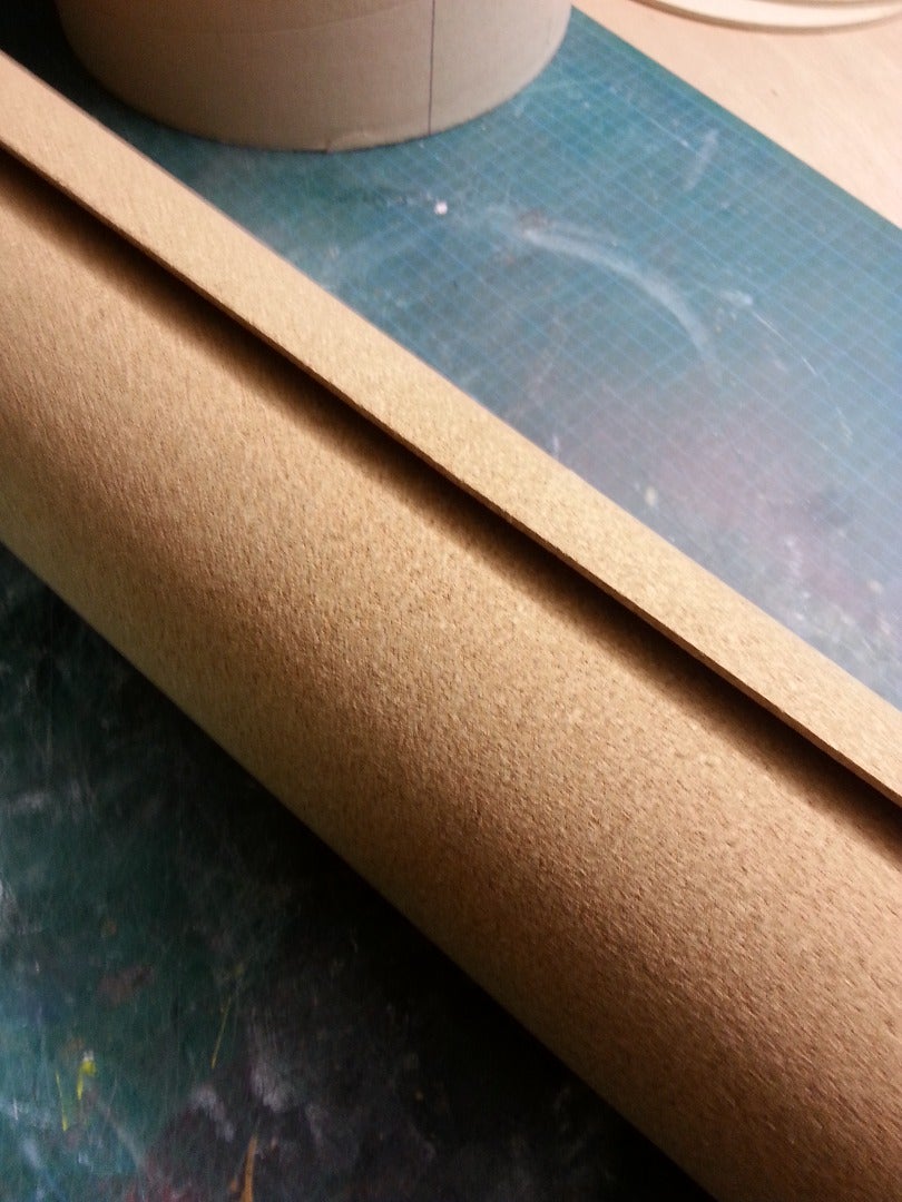

I've forgot to take pics on the cork step ><

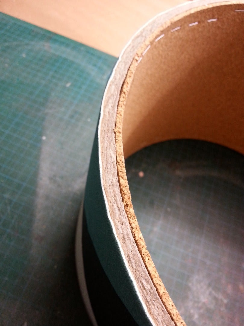

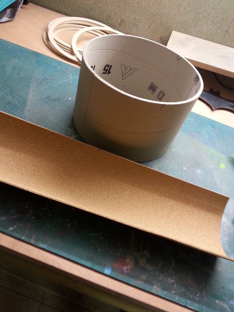

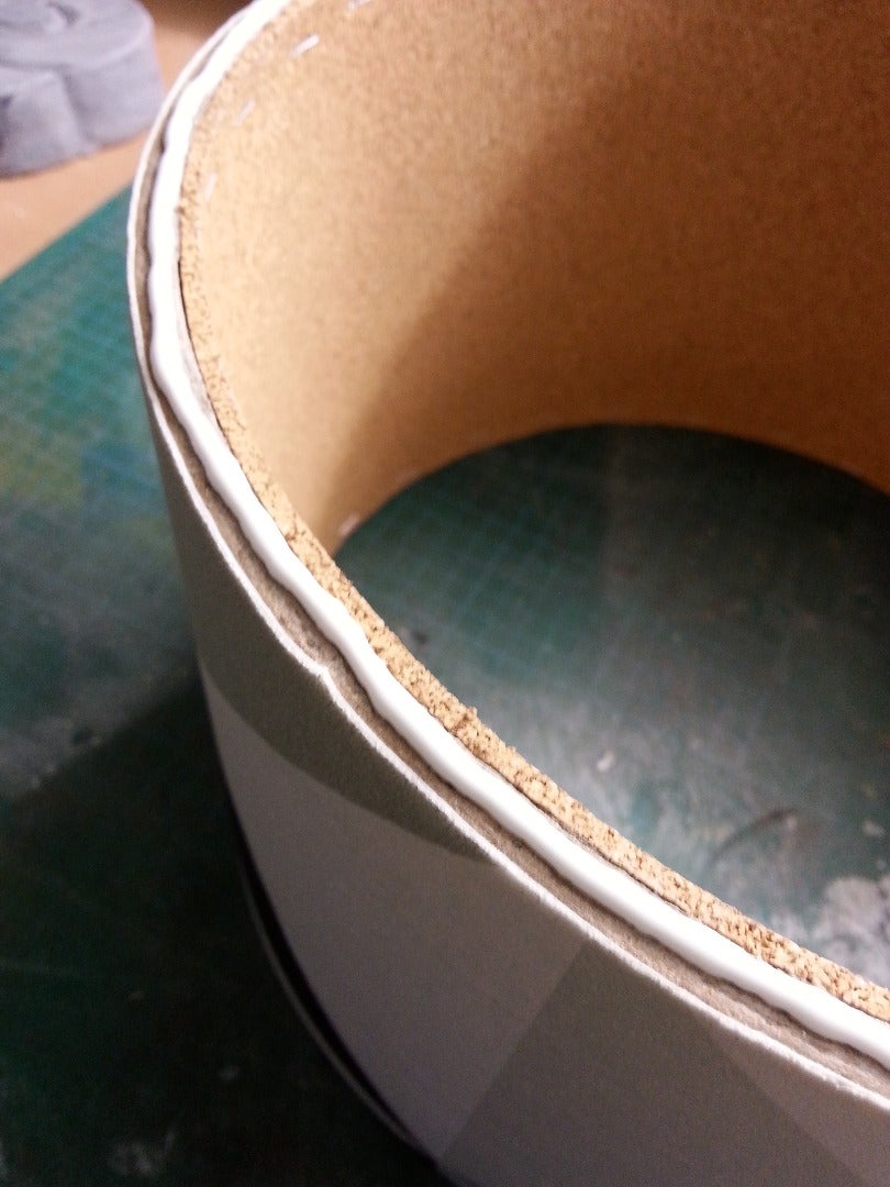

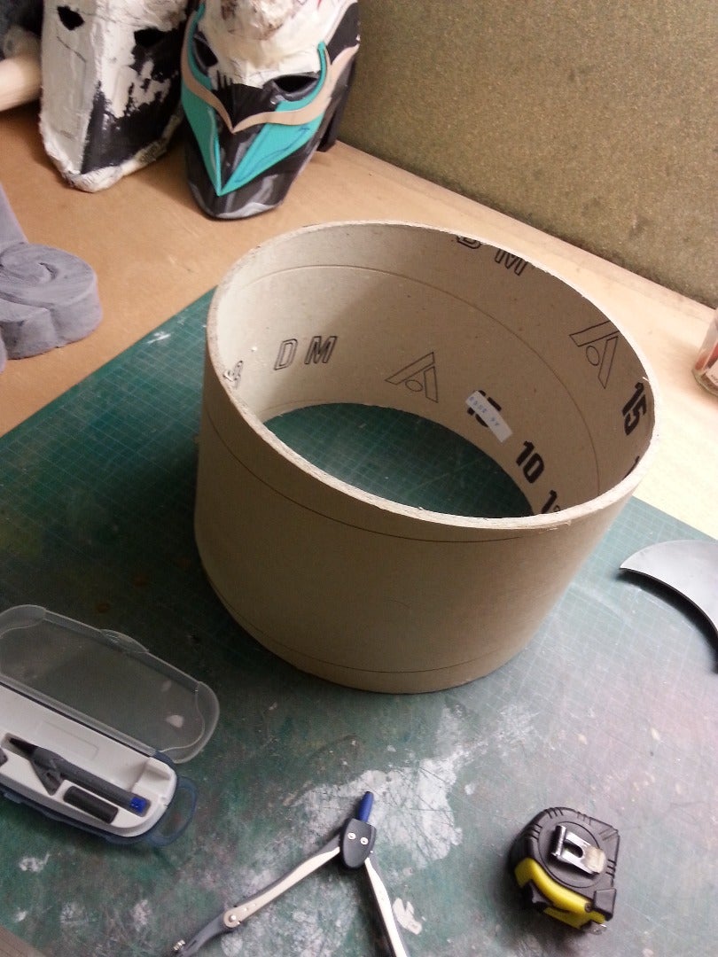

anyway, i take measurement of cardboard pipe diameter and perimeter ) and i trace the cotation on the cork roller. i cut the part with a simple cutter.

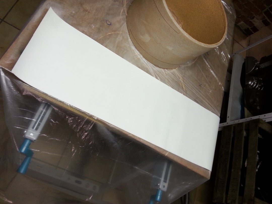

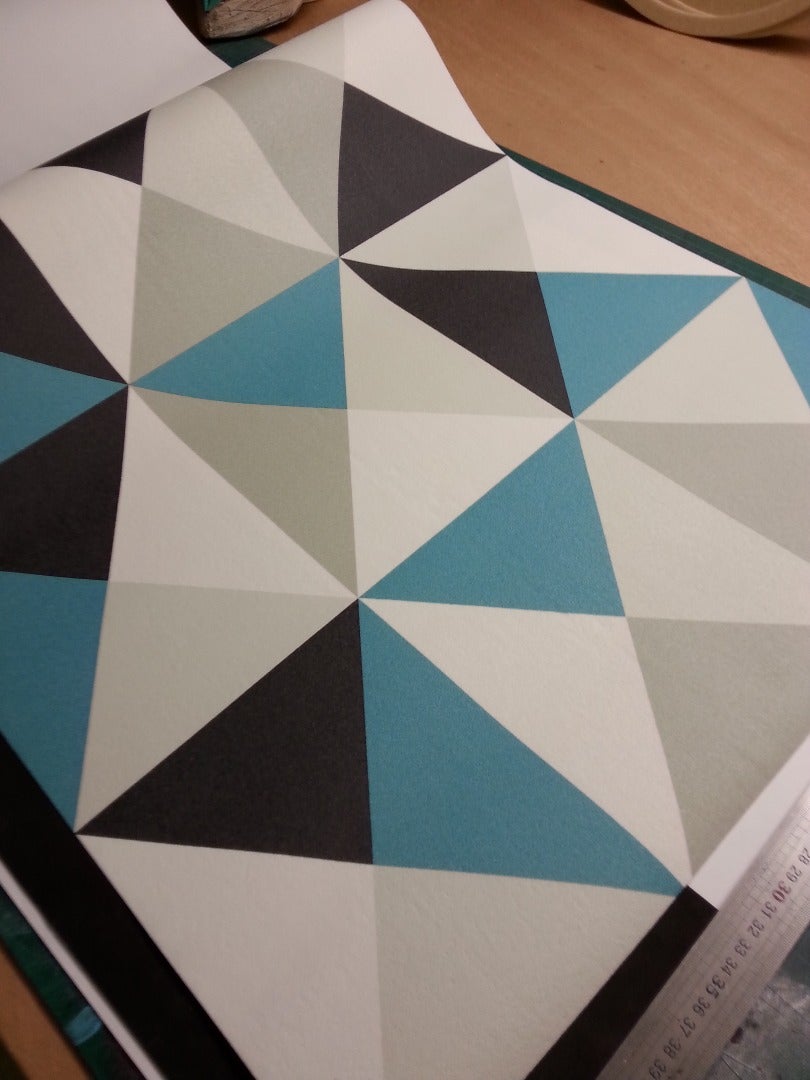

I repeat the same action on the wallpaper that i will use for the exterior of the cardboard pipe.
To fix the cork on the cardboard i apply wood glue and then i clip it on the cardboard. finally it's better to use contact spray glue ;)
To fix the wall paper, i use CONTACT GLUE in SPRAY. This is so useful and so perfect to glue big surfaces !!

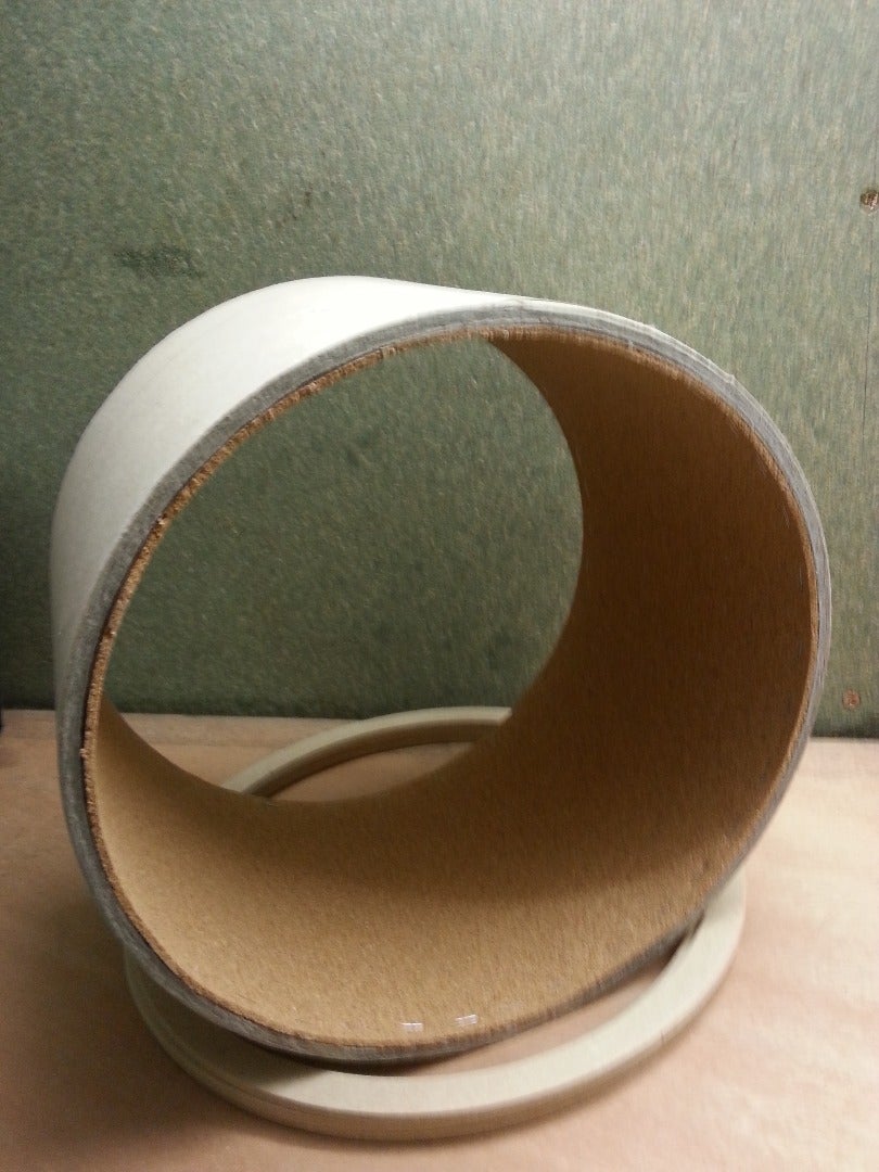

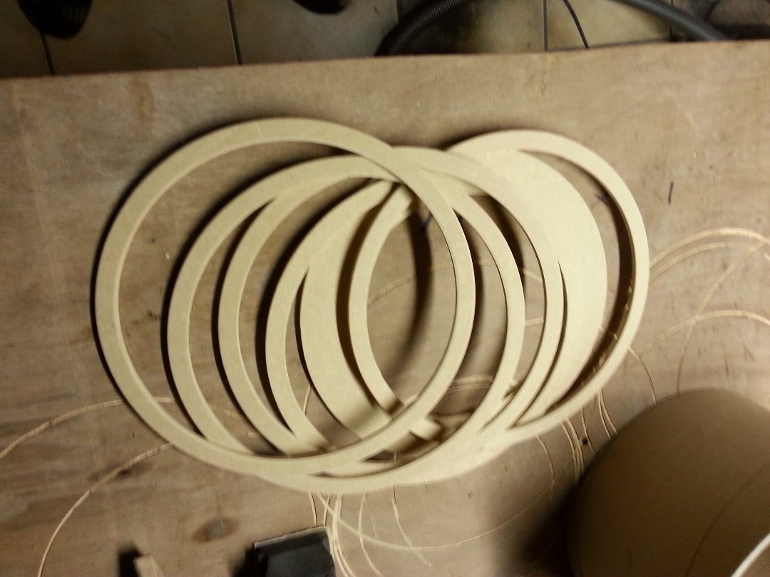

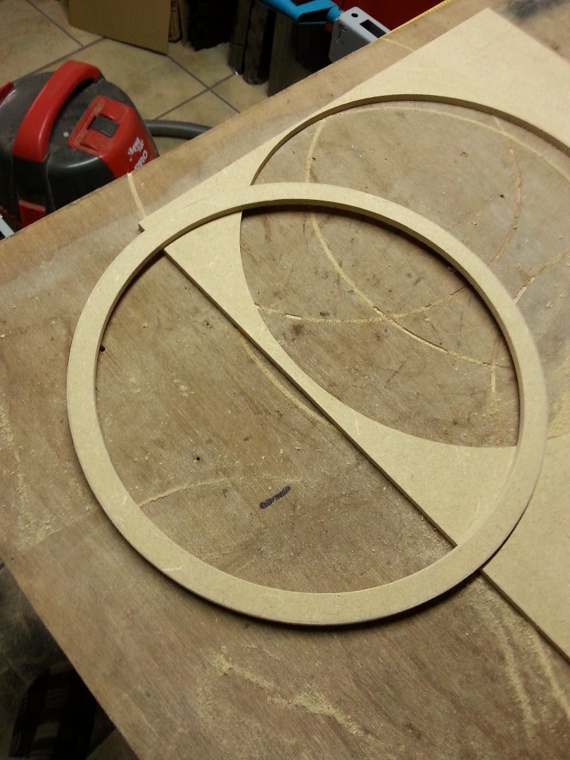

Once the cork and the wallpaper are glued, the tranche become dirty too. So we will cut some circle to hide this.
I use the TRIO DREMEL tool to cut perfect circles.
I measure the diameter of the cardboard pipe and trace it on the wood with a compass.

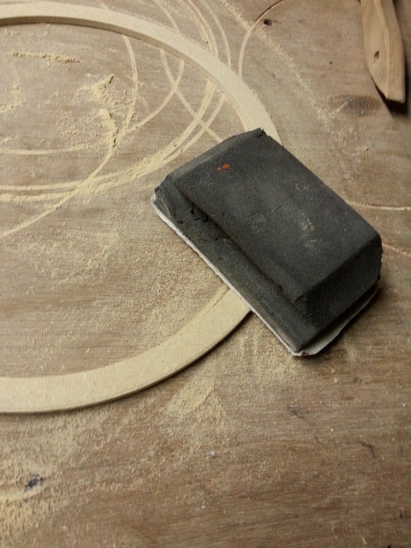

When circles are cut i sand them.

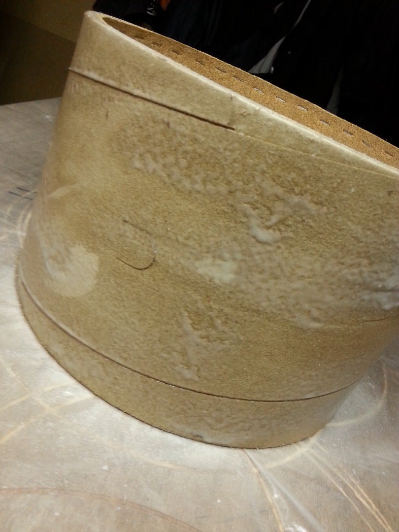

And then i glue them with wood glue. I apply a high pressure on the parts during 24h

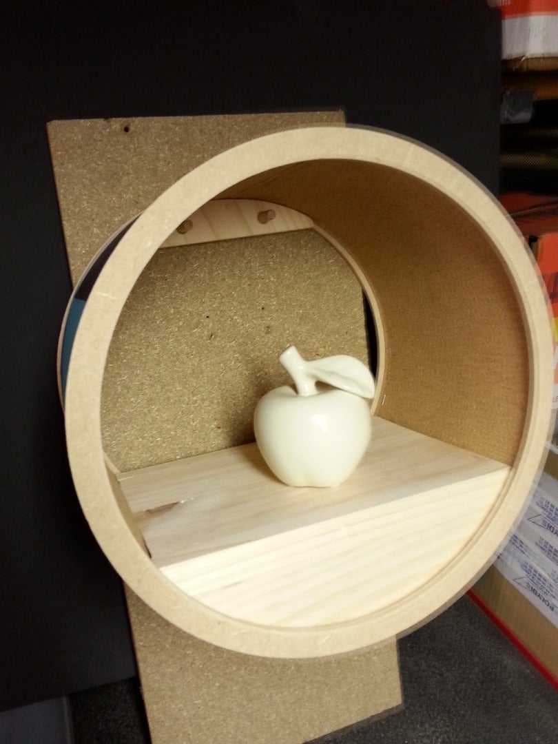

Step 3: Here You Got the Choice :
This step is optional, it's a question of taste
you can use the shelf like this or you can create a little board to get a plane surface in the shelf to put some objects or small books.
so how to create a little board ?

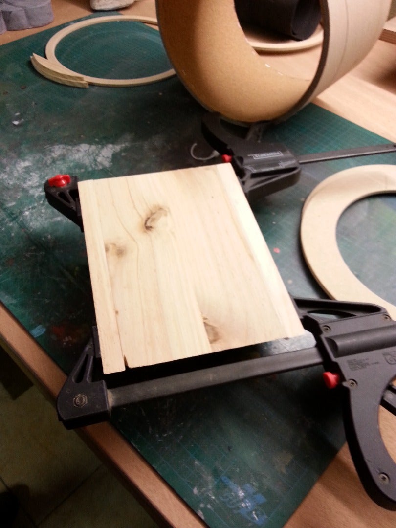

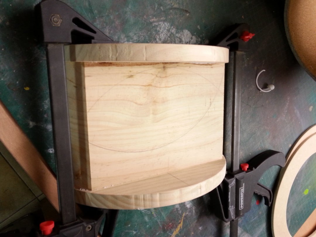

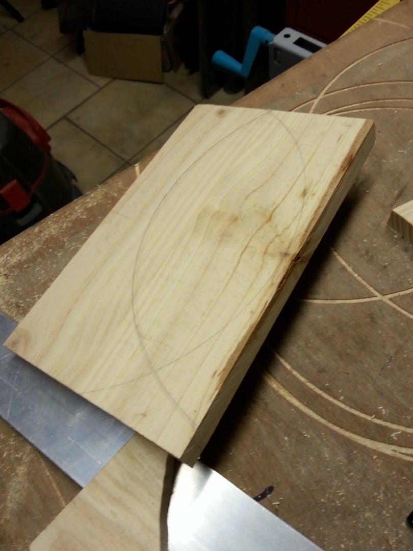

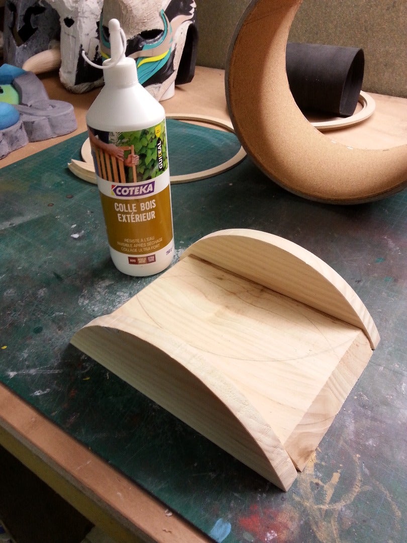

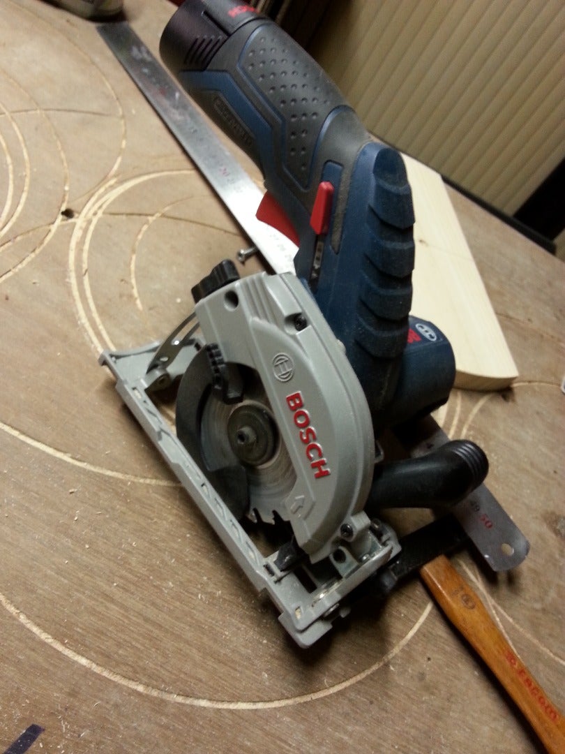

First : cut 2 new circles in 18mm thickness wood. the size of the circles correspond to the interior size of the cardboard pipe when the cork is glued.
you can also cut a third circle for the next step ;)

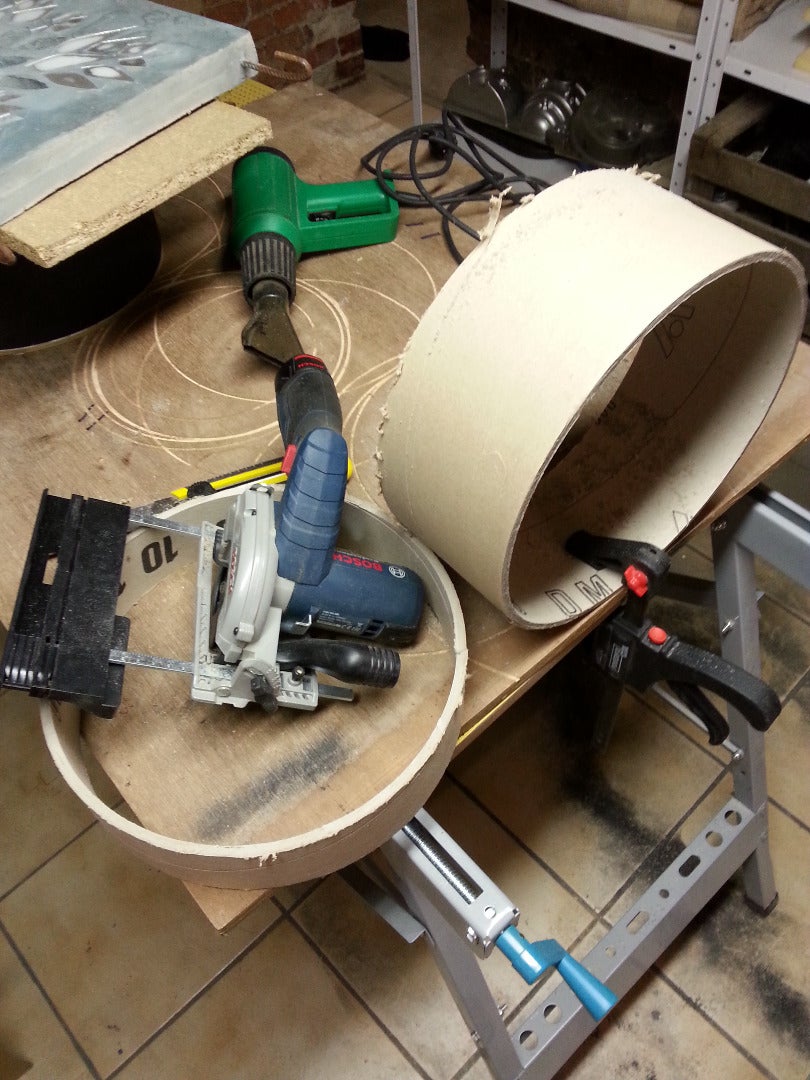

choose a height for the board and re-cut the circles to get 2 half circles. using a circular saw.
Cut the board and cut the edges at 45° if you don't do it , the board will not pass into the shelf ;)
Glue the different parts together using clamps.

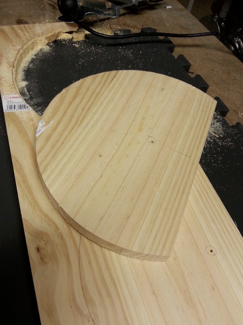

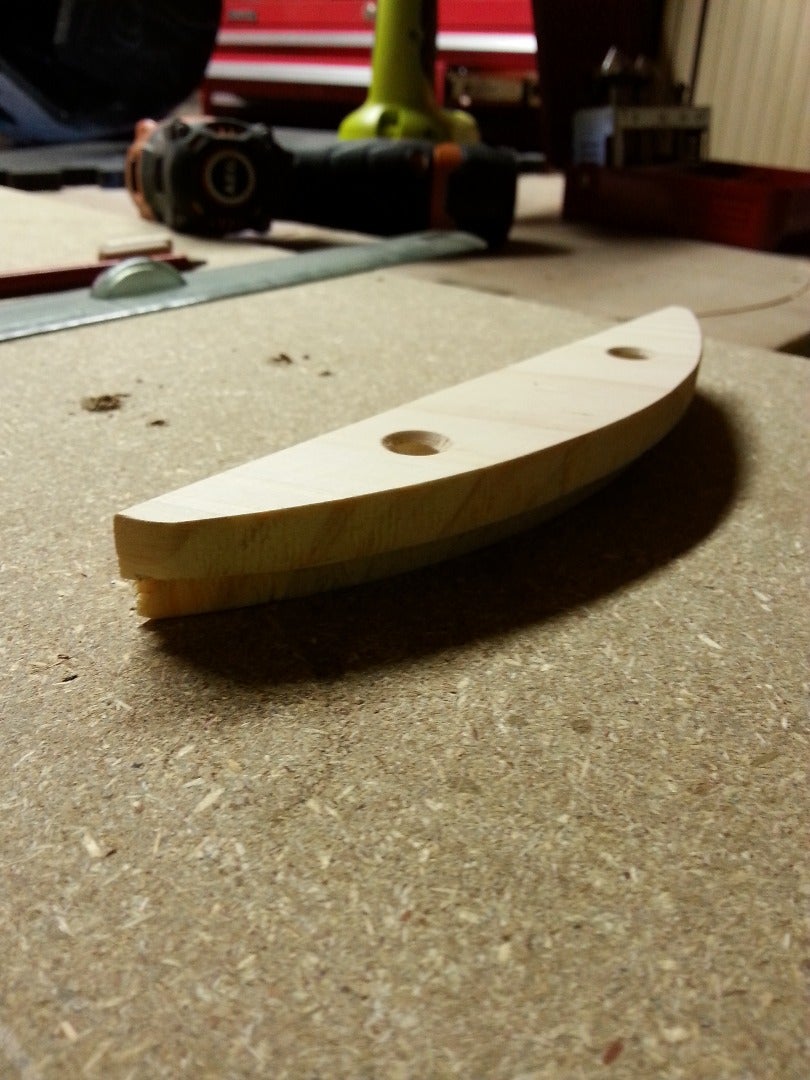

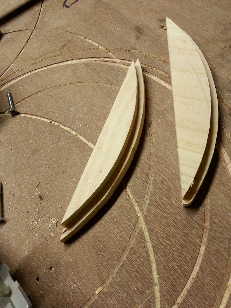

Step 4: Wall Fixation System.
i don't know the right term to describe this step.

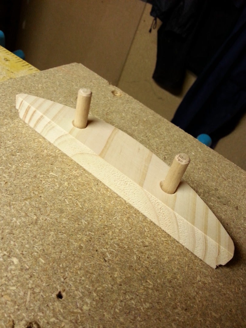

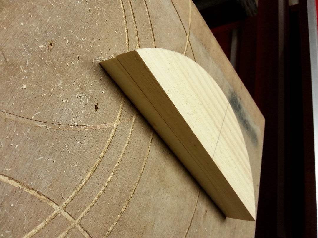

I use a wood cutter for planing on the contour of the circle.

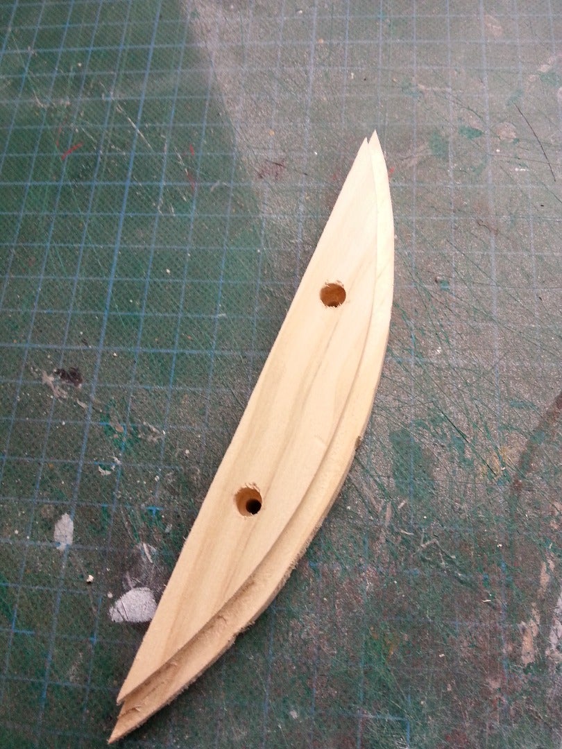

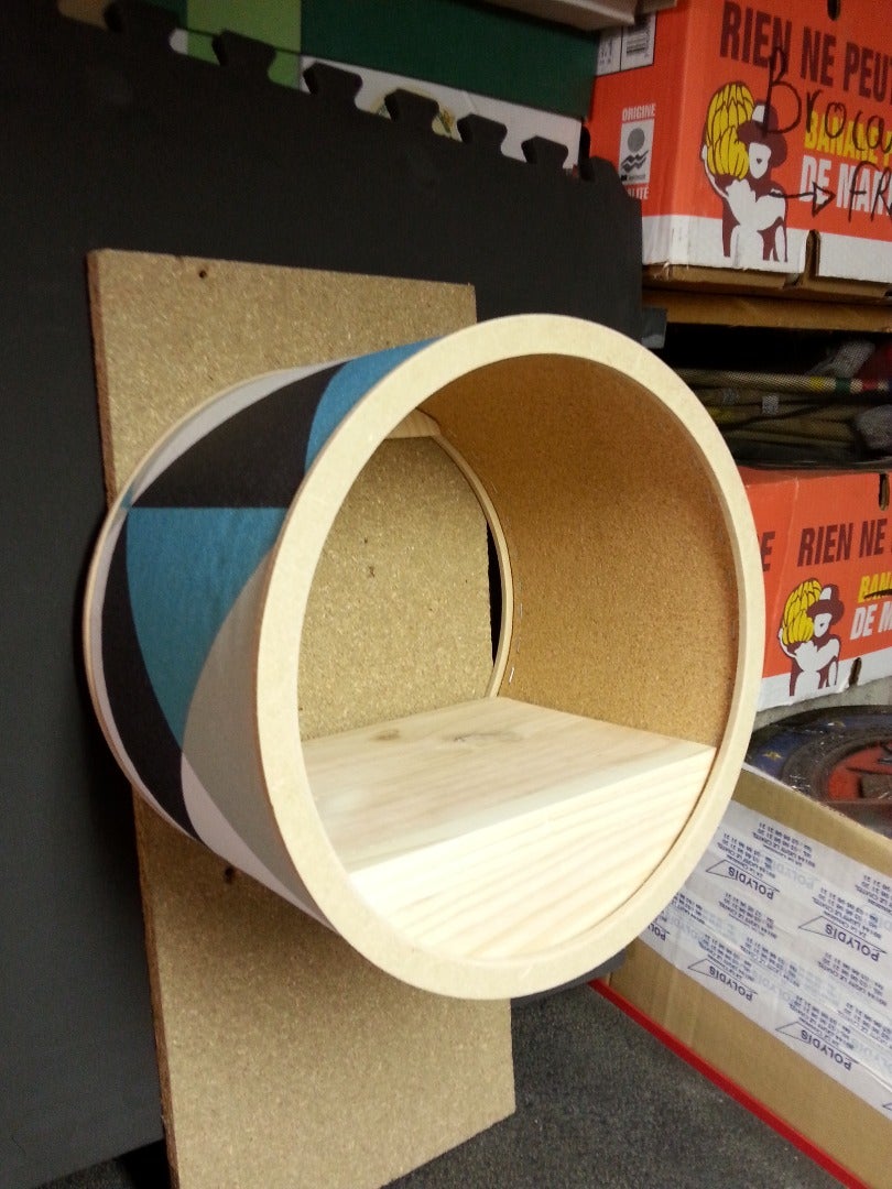

I re-cut the circle to obtain the piece on pic 3.

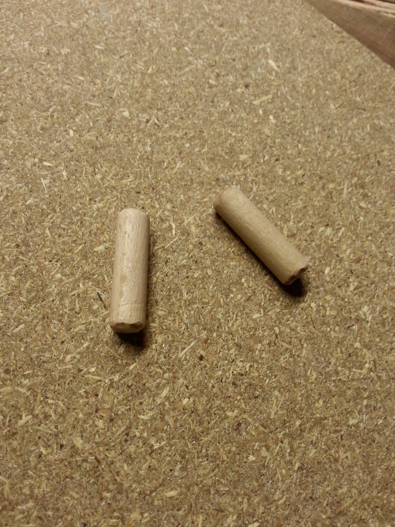

drill 2 holes : first use a diameter 8 drill and then a diameter 3 drill. we will put a piece of wood in the 8 mm hole to hide the screw head.
Screw this piece on the wall and put the cardboard pipe on it.
The shelf can not tip thanks to the shift on the wood.
I'm really sorry i got big lacuna, i don't know the exact vocabulary :( i think it's understandable with pictures

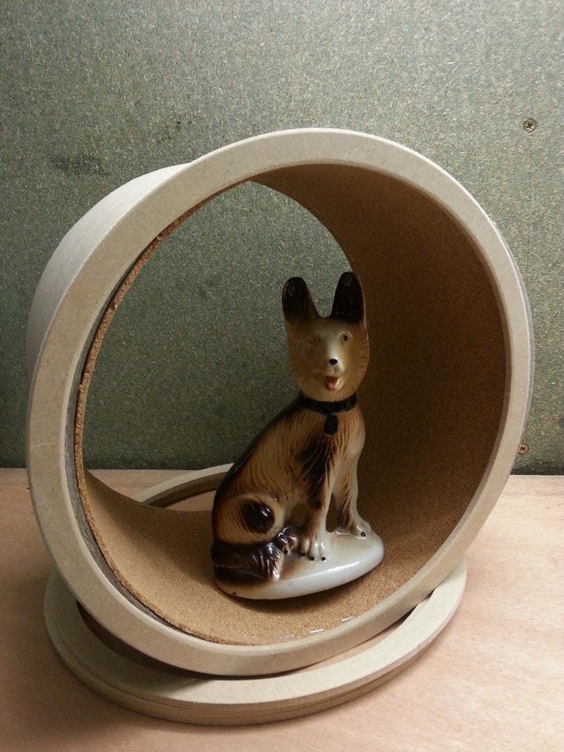

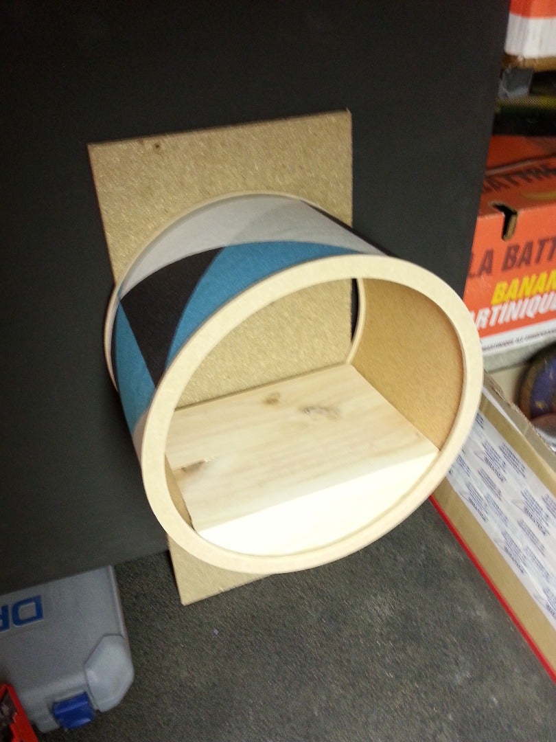

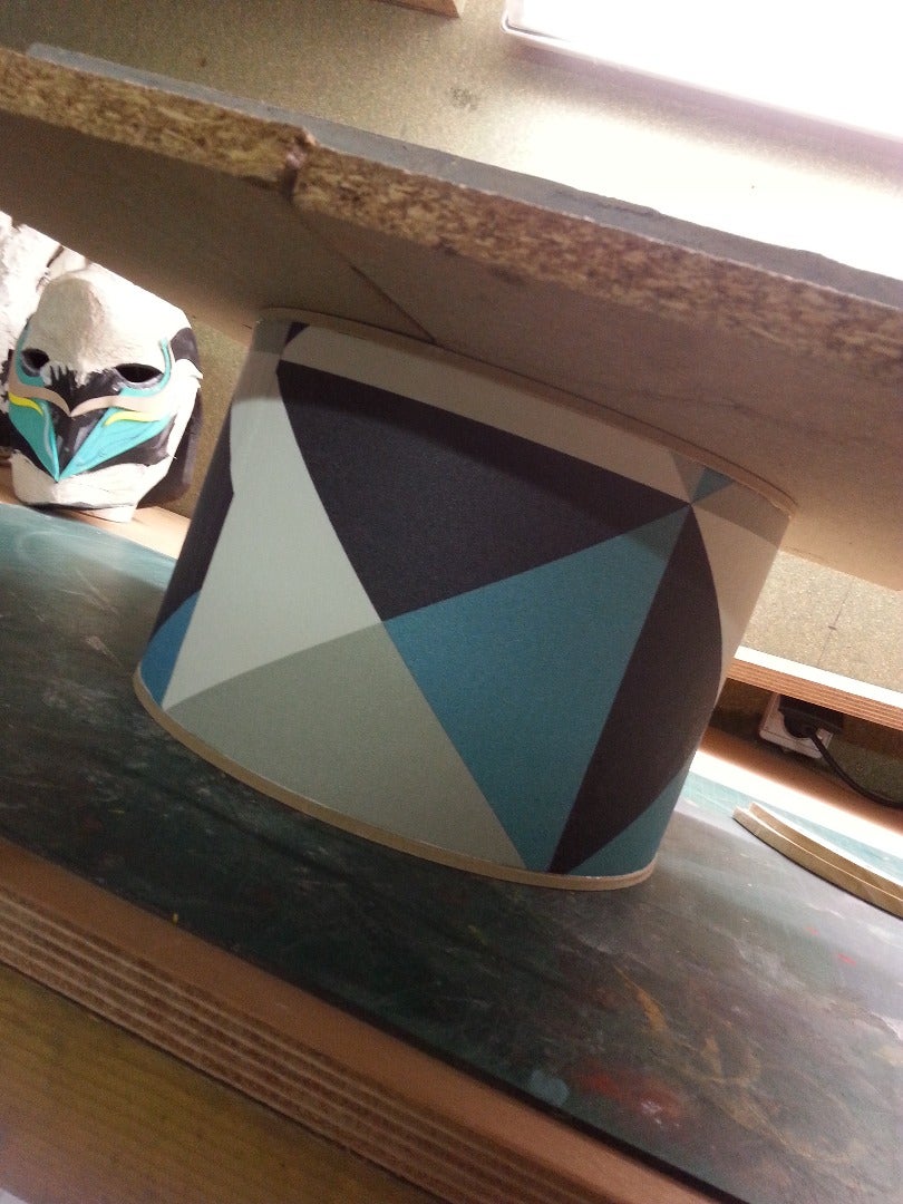

Step 5: Let's Fix It on a Wall !!
screw the wall fixation on a wall and hide the screws with a little part of wood ( you can hang your necklace for exemple )
and ... just lay down your shelf
We are done ;)
you can combine the different shelf to create wall design, exprime yourself and be creative !!!!
Step 6: Tips and Tricks
you can reduce the depth of the carboard pipe. You can recut the pipe by using the same circular saw we have used before ;) it work perfectly
