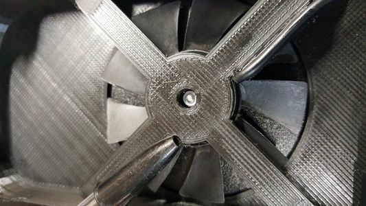

The STL file takes a few hours to print.
I printed mine with 0.1mm resolution at 85% infill with the flat-side down.
The fan I used was a recycled 5V 80mm brushless fan from an old laptop cooler stand. (Any fan can be used, as long as it is 5v and 80mm in diameter.) I simply disassembled the fan parts and set them aside.

One of the usb cables will need to be cut in order to solder a source of power to the 5v fan. In this case, the shorter cable will be cut near the end. Remove the outer jacket to expose an inch of red/black wires. These will be stripped and soldered to the positive and negative terminals of the fan board.
After soldering, the coil should be installed as the picture shows. The sleeve bearing from the brushless fan is then pressed into the center of the plastic hole, which should lock everything in place due to the expanding plastic.
Step 3: Pop on the Fan
The fan should slide into the bushing that's been pressed into the hole on the print.
Any parts of the fan that were removed can be installed now (for me, it was a rubber o-ring and a plastic snap-washer to hold everything together.
