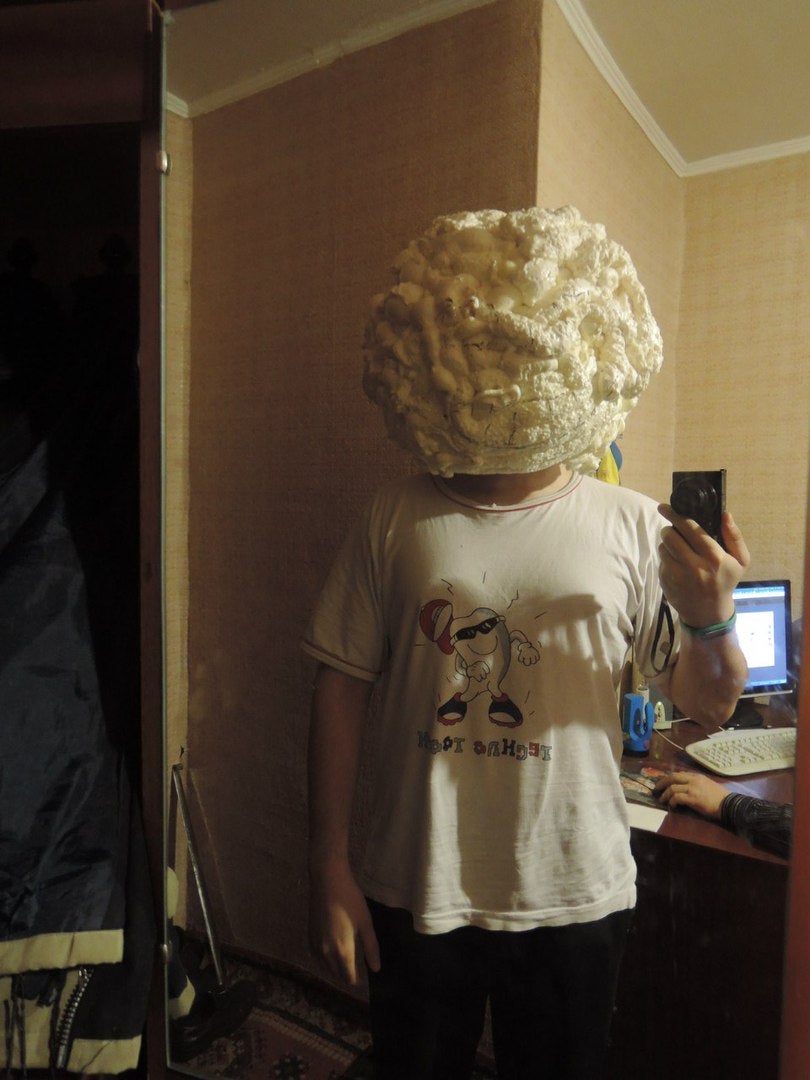

The frame is ready. Now you are going to have a really bad time :) . Here I used two foam container, but in fact could be used only one. It is advisable to do some stand for our carcass. I used inverted pot in which was inserted sushi chopsticks like in picture 1 (but I think you could use anything more useful)
This step is boring because foam likes to slip down, and more foam you place - more time it needs to dry. So we start from top and slowly lay it on with small spiral stripes. Try to make steps in a small areas to make it more easily to dry . When it dries in 6-8 hours, turn and make another area, and so on, until our ball becomes something like a burst of a bomb :) (Picture 2) When the papier mache is fully covered, fill holes with foam. This whole step should take approximately three or four day.

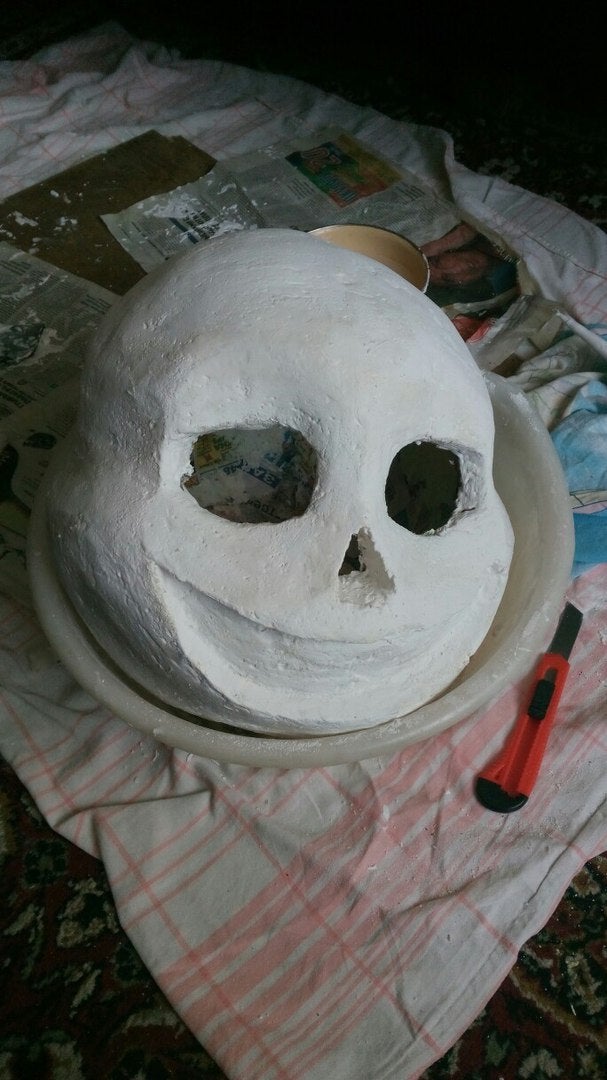

Finally the most satisfying part starts after a few days of work: Cut circle on one side of this burst-of-a-bomb straight to papier mache (below mouth part), with size approximately to fit of your head (preferably cut a bit more for ventilation).
And start to remove our foam frame from inside with hands, spoons, scissors, knives and a bit madness, till only papier mache will remain inside. (Should be like in picture1)

We continue to show REAL KNIFE skills and we cut a smile (Joker you?), temples and nose (as in pictures)
Especially take a look at eye cutting (it was hard for me) - cut them once roughly in proportion, and do not touch them at all, or later you have add some foam or glue to them

Make shapes of the sketch by using the sand paper, and when it becomes look like in our sketch you can start to fill holes. And believe me - there would be a lot of them in foam. For this I used "liquid nails" type of the glue (It is on the background. White and orange)
It costs nearly the 5 USD. Also it is cheaper to use the "liquid nails" in tubes. By the way, this glue is very handy if you need to add size to our form.
Step 9: Stucco (fill Holes)
Now start to cover it with stucco. I took the cheapest one, it cost 1 or 1,5 USD. The main objective now is to fill all the holes that we have (But in real life you could stop with 90% of holes. Next step is a PAINting step). Please not use a lot of plaster , because is really heavy. Sans is enough big-boned :)

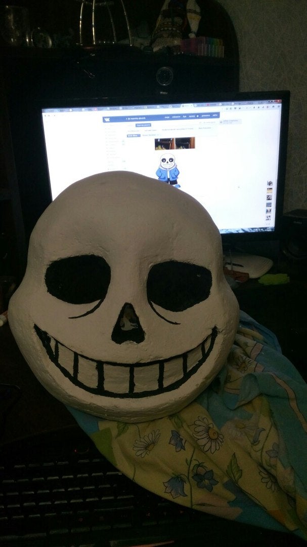

Paint. All. In white.(Did you ever see non-white Sans?)
Draw lines with marker where it will be painted in black color later.
Step 12: Eyes, Nose, Tooth Ets
Suddenly! Paint lines with black.(nose , eyes, tooth ets)

Paint mosquito net with marker. Paint two dots with white acryl as eyes. Paint all of holes on mask with white color. and black color. And make more details and correction if you need it
Main part is ready (WooHoo!)

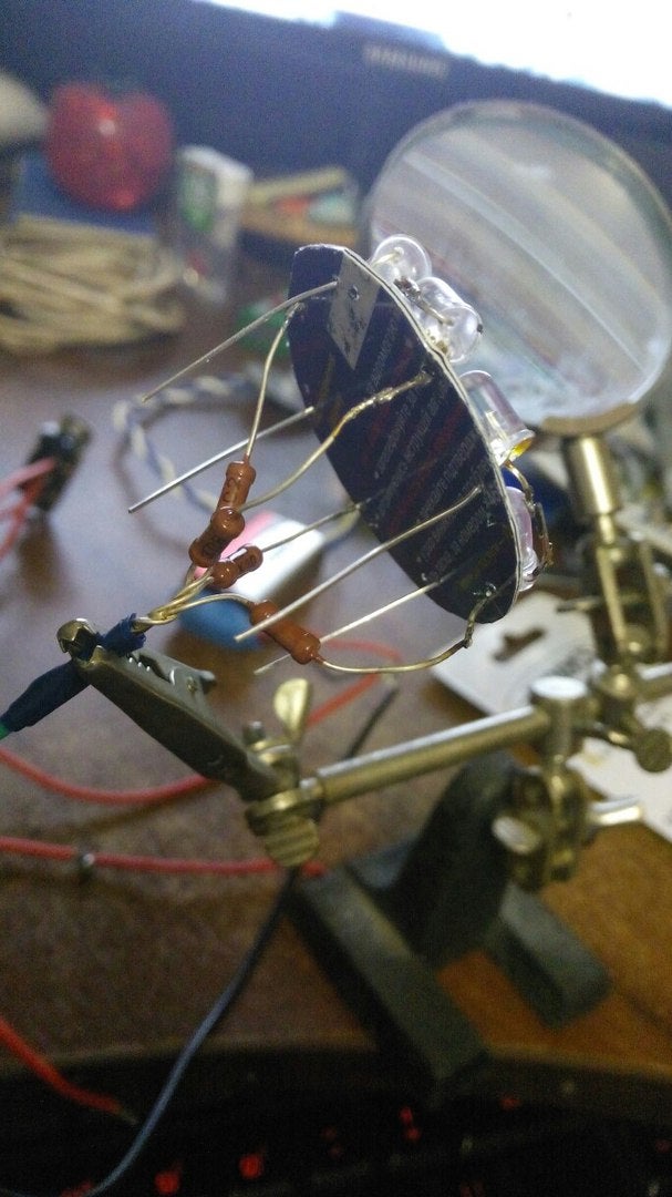

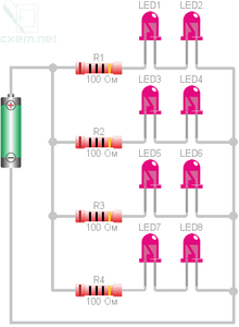

Step 16: Some Schemes
First thing you need to know about LEDs and power source, if you have 9v battery, and 3v LED, do not connect them directly without proper resistor. LED will burn out. Also if you have 9v battery the best efficiency is when you connect up 3 x 3v LEDs series (9v=3v+3v+3v), but still it needs 1 Ohm resistor. But with parallel connection you can use any number of LEDs, but you must have resistors for all of branches. And if we would have a lot of LEDs in parallels, the source will be low of energy too soon (but in our case it is not important, 10 LEDs connected to 9V battery wont use much energy)
There are a lot of sites in web where you can count a scheme, with given LEDs and source parameters (direct current is 20 mA). Here you can see schemes for my connections. As I told I use 3-position switch. Where middle position is all of LEDs are off, left position is all white LEDs are on. And right position is all blue LEDs are on. Hard to paint it in paint, so there are few photos :)
Also - it desirable to place LEDs on a substrate so they do not shine your eyes, when they are turned on. I made substrate of conventional plastic card. After this action it is useful to paint substrate in black.

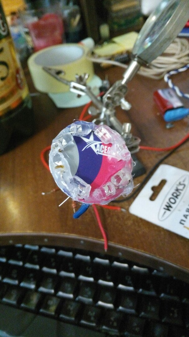

Step 17: Shiny Eye Trick :)

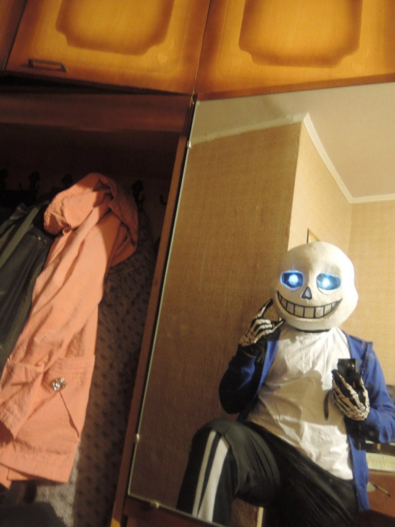

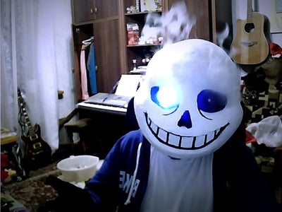

Here is one trick I want to share with - when you sold scheme, cover blue LEDs with thermal glue. The effect will be look like if they are fused. Also it is useful because it will help to hold LEDs on substrate
Step 18: Look to Inside
When you done with scheme and thermal glue (it is like to draw an owl, yeah? :) ). Put it in into mask. Try to tape battery at side, that it wont interfere with your face. For wires I used paint tape.
On the photo, where you can see white and blue wire, I attached it with thermal glue
Step 19: End
So now, ensure that Sans mask fits perfectly and wires do not interfere. If something is preventing - use tape or thermal glue (but not use thermal glue on power source :) ) and... PREPARE TO HAVE A BAD TIME >:)
