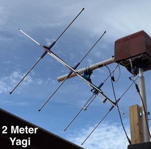

Step 2: Building the 2 Meter Crossed Yagi
The 2 meter Yagi uses the spare boom, 46” (117cm) long, and the elements are 9 mm outer diameter. I used mmana-gal basic, a free program you can find online, to model a Yagi. That was a starting point. The numbers I got are close to the actual dimensions I finally used, except for the driven elements. The main reason for that has to do with how I mounted the driven elements for both antennas: insulated from the boom with plastic mounting brackets, made on a 3D printer. (See my stl files.) The reflector and director elements can remain shorted to the boom and work perfectly as in any Yagi, if you like. But the reflector on the 2 meter Yagi has to be longer than 36” (92cm), so I used two shorter tubes mounted to the boom with a plastic bracket, and a jumper wire to make the entire element longer than 36”. For me, finding a reasonably priced tube longer than 36” was difficult. Of course the electrical length of two 9mm tubes with a 2” jumper wire is probably different from a long 9mm tube, so the mmana-gal numbers may not be perfect, but a careful estimate yielded good results, as you will see from the antenna patterns of the finished antennas.

Then, with the second boom of the same length, I constructed the 2m Yagi, with aluminum tubes, centered on 145 MHz. In this case I made the driven elements with the 9mm tubing, and built gamma matches for each. Again I used printed plastic brackets to keep both primary and secondary dipoles electrically isolated from each other beyond the Y-branching split away from the antenna feed point, and to keep the dipoles 90 degrees apart in their phase. And each dipole is insulated from the boom. The element lengths, including the 2” (5cm) center jumpers, are as follows:
Element Full Width
Reflector 99cm
Driven Element 91.4
Director 1 90
Director 2 89
And the distances forward from the previous element:
Reflector 0
Driven Element 35.5cm
Director 1 40.6
Director 2 35.5

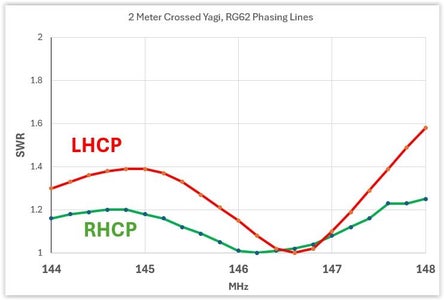

The phase delays have to be fairly precise, especially on 70cm. How long is the phase delay contributed by the path through the relay? It can’t be ignored. Another problem is that you can’t always trust the published velocity factor of your coaxial cable. You can’t just measure with a ruler if you use a relay. You have to measure it with a nanoVNA, and at each step of the construction of your delay line harness. I found through many different measurements of different coax lengths that my brand new RG59 had a velocity factor of about 0.71. (The published values are 0.66 for solid PE and about 0.84 for foam. Mine must be slightly foamy.) And the true electrical length through two poles of a double throw relay connected through a short stub is more than 6 inches, so careful attention is important.
Here’s how to measure and prune the coax: first, make sure the nanoVNA is calibrated for every test lead and every frequency sweep for each type of test. Just store them, but if you change your test lead you must recalibrate. Now, instead of testing in the SWR format, use the PHASE format. Connect the nanoVNA to the length of coax you’re testing, center to center conductor and shield to shield, and with the far end of the coax left open. One oversimplification is to imagine that the nanoVNA sends out pulses and measures the time it takes for reflections to return. Reflections will return from every point along the line where there is an impedance discontinuity, whether it’s from the open end of the coax, a length of coax with a different impedance, or a simple relay from Amazon. The nanoVNA will display a vertical jump at every sweep frequency corresponding to a 1/4 wavelength of cable at that spot on the sweep. A longer length of coax represents a longer wavelength and so the jump on the screen will read at a lower frequency for that distant reflection, compared to the screen trace jump corresponding to a reflection from a spot closer to the nanoVNA test point. You can map out the lengths of each bit of coax, where the relay is, how long the path is through the relay and the length of the next bit of coax, and so forth. See my nanoVNA photo. Write these frequencies down. Then get a calculator, take 29980 (adjusted speed of light) divided by the measured frequency in MHz. Then divide that by 4. The result is the electrical length in cm of the spot along the line where the nanoVNA’s signal bounced off. Now if you trim that coax to where the jump on the nanoVNA reads, say, 437 MHz, you know that that length of cable is 1/4 wavelength at that frequency, regardless of the true velocity factor of the coax or relay or whatever the wave is traveling through.
I recommend that you work backwards starting from the point of connection of the primary dipole itself (without the dipole connected yet) to the where the relay will be mounted, but without the relay yet connected. This is constricted physically along the span of the boom between the driven element and the position where the relay will be mounted. Use the nanoVNA to measure the true electrical length of that stretch of coax. Then attach the relay but only that end, and in the unenergized mode (short RHCP path). Measure the path through the coax and the relay. The difference will be length of the path through the relay. Then attach the next length of coax, heading back towards the transmitter, to where it will connect to the feed line to the secondary dipole in a Y-split, but don’t yet connect it to anything else, leaving that coax end open. Measure that combined length with the nanoVNA. Whatever that length is (the path from the common feed point through the relay to the primary dipole), now you know also what the electrical length must be for coax going straight to the secondary dipole. It must be 1/4 wavelength longer at 437 MHz. And you really should measure and trim that new length of coax to that precise length also using the nanoVNA. You can’t just get a tape measure and use the published velocity factor for the coax.
Then finally you have to measure and cut the length of coax that is switched in to the make a longer path to the primary dipole for the LHCP state when the relay is activated. Cut a length of coax longer than 1/2 wavelength at 437 MHz with a best guess for the real velocity factor you’re dealing with (you should have a good idea by now), and connect one side to the relay. Then activate the relay so that the 1/2 wavelength stub is connected into the path to the primary dipole. Little by little trim that length down while then temporarily attaching that other end of the long coax stub to the relay, both shield and center connections, and measure it with the nanoVNA to where the total true electrical length from the future Y-branch point (again without the line to the secondary dipole yet connected) to the feed point of the primary dipole, is precisely 1/2 wavelength longer than the short path in the deactivated (RHCP) mode. It helps to have a pad, a pen and a nearby calculator in one hand, and a good non-dominant hand to hold the coax to the relay. A nanoVNA with a decent sized screen is also a plus. Once you’ve got all that done, complete the soldering at the relay and don’t forget the heat shrink tubing. Connect the proximal side of the coax-relay-coax system going to the primary dipole, to the proximal end of the 1/4-wavelength-longer line of coax headed towards the secondary dipole. Then connect the distal ends of each coax line to its respective dipole. You’re just about ready to connect the common feed branch point to the 50 ohm feed line to the shack. But wait…
Step 6: The Impedance Matching
It turns out that if you use 50 ohm coax for the phasing harness, it won't present a 50 ohm match for the main feed from the shack. And it’s not just a simple question of two 73 ohm dipoles in parallel cutting the impedance to 36.5 ohms. If the dipoles are not in phase the impedance can be different, and if they are in the same plane there may be coupling between them reducing the impedance. It turns out that a better match for this system is to use 93 ohm coax (I used RG62, which available at my local electronics shop) for all the connections within the phasing harness, and feeding it with 50 ohm coax from the shack. Please see my SWR charts for my 2 meter antenna. This gives an impedance very close to 1:1 SWR near resonance. If you can't get RG62, an alternative is to use 75 ohm coax for the harness (RG59), and with a 1/4 wave coax transformer between the 50 ohm main feed line from the shack and the starting Y-point split between the feed to the primary dipole and the feed to the secondary dipole. The transformer is 37.5 ohms, made by putting two 1/4 wavelength pieces of 75 ohm RG59 coax in parallel. This should theoretically yield an SWR around 1.2 to 1.4 near resonance, which is in fact what I have observed. I have tried both versions of the harness for my 2 meter antenna, and I may switch to the RG62 also for my 70 cm antenna, but I currently use 75 ohm coax for the latter. Both versions of the harness are effective.

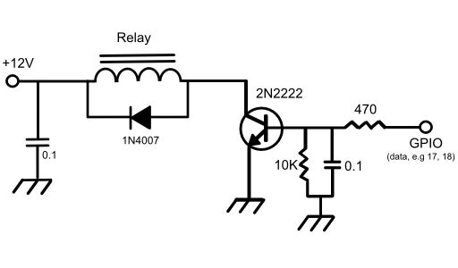

Step 7: Controlling the Relays
You can control the relays by running a couple of extra cables to the shack with toggle switches. But I used WiFi. My rotator already has +12 volts and a WiFi Raspberry Pi 4 at the masthead, so I installed a LAMP stack and built a two channel 2N2222 switch to get two of the GPIO pins to drive each relay independently. The web page shows two buttons, one reading “2M R” in green, which switches with a mouse click to “2M L” in red, and the other which can toggle “440 R” green to “440 L” in red. See my index.html, toggle.php and toggle_gpio.py files, which go in /var/www/html. Make sure the file ownerships and permissions are appropriate.

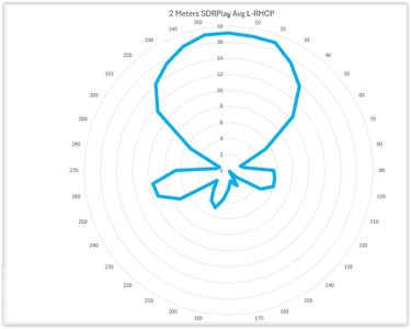

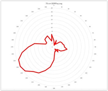

How well does it work? First, take a look at the gain pattern polar plots for each antenna. 2 meters is in blue, and 70cm is in red. I measured received field strength in dBm of local repeaters in 10 degree increments, measured with an SDRPlay SDR receiver.. The values were very similar between RHCP and LHCP, and so I averaged the readings at each declination. The received signals were adjusted in Excel so that signal strengths are plotted on a relative scale with the weakest signal is about 1 and all other signals are in dB above that. I am satisfied with the result.
For 5 months I used these antennas in fixed RHCP configuration before adding the phasing relays and had already made almost 1000 contacts, mostly SSB and some FT4 and FM, and even a few satellite contacts on CW, in 41 states. How much better is it being able to switch on the fly from RHCP to LHCP and back to RHCP? In most cases it does make a difference, often a tremendous difference, and what is really remarkable is that the relationship can flip on a single pass of a single satellite within 45 seconds and then back again. This is true sometimes of my uplink and sometimes my downlink. It can make the difference between good copy and no copy, RHCP or LHCP, and unpredictably. I suspect that the polarization of the tumbling satellite and the changing polarization from propagation of the signal through the ionosphere in a magnetic field is occurring, which Faraday observed in polarized light almost two centuries ago.
