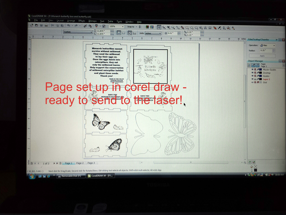

Download the file I provided. It's in dfx format and I use corel draw 14. I have an Epilog 35 watt mini 24 laser.
I used 1/8" x 12" x 12" baltic birch plywood for this project. You can mask the plywood with tape - I had chose not to and had some burn residue to sand off. You can finish with a clear lacquer first before cutting it out then wipe off the burn residue with rubbing alcohol after it is cut out.

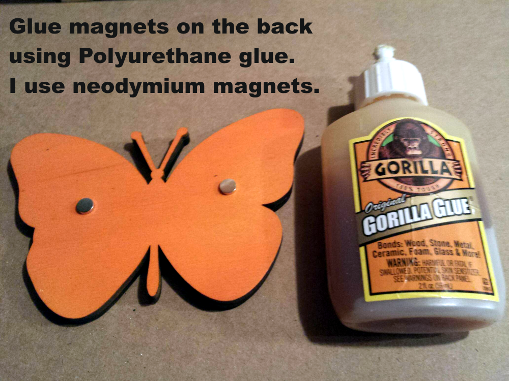

I used neodymium magnets for the back of the butterfly. I glue these on with a polyurethane glue. Super glue will hold, but from my experience, they will fall off over time with super glue. They won't fall off with the polyurethane glue.

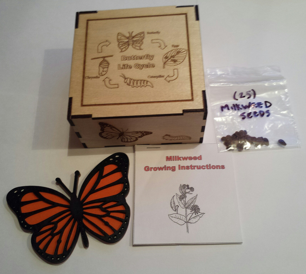

There you have it, your Save the Monarch Butterfly Kit!
It contains: One box, 4 3/8" square x 2 3/8 high (a place to save all the seeds you find in the upcoming years), a life size Monarch Butterfly to hang on your fridge, Milkweed seed growing instructions and, of course, the Milkweed seeds!
