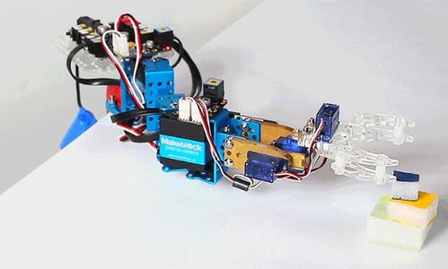

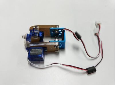

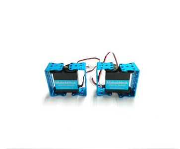

To create a scara arm with two big metal servos and to make its end move horizontally. Just think it over, what can we do with scara arm? As you see, the vertically moving scara arm can easily catch and move the Tower of Hanoi. I guess you must be surprised by its continuous and smooth actions, aren’t you? This is the scara robotic arm I built to solve the Towers of Hanoi puzzle. It uses two MEDS150 Servos, a mini gripper and a lifting platform with 9g Micro Servos. It provides a circular work envelope.

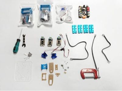

Step 1: Meterial List

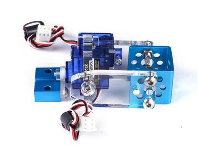

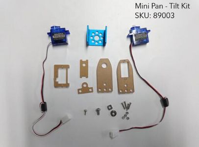

·1 x Mini Pan - Tilt Kit
· ·2 x Robot Servo Pack-Blue
· ·3 x Beam0824-048-Blue (4-Pack)

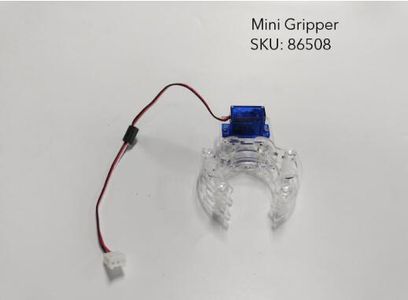

· ·1 x Mini Gripper
· ·3 x Me RJ25 Adapter
· ·1 x Me Orion(Base on Arduino UNO)
· ·3 x 6P6C RJ25 cable-20cm(4-Pack)
· ·Socket Cap Screw M4x8-Button Head (50-Pack)
· ·Socket Cap Screw M4x14-Button Head (50-Pack)
· ·4 x Plastic Rivet R4100 (50-Pack)
· ·1 x Micro USB Cable
· ·1 x G Claw

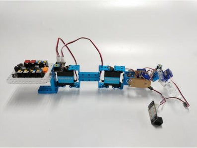

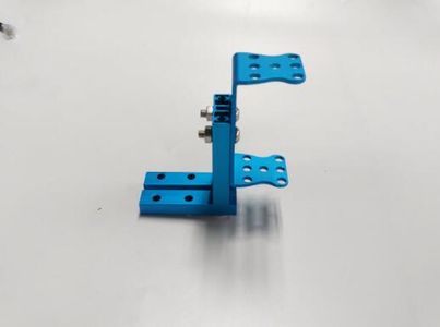

Step 3: Building
Robotic Arm Learn more

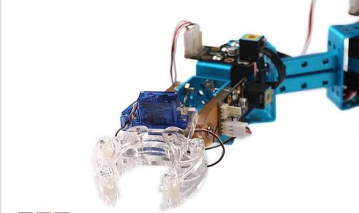

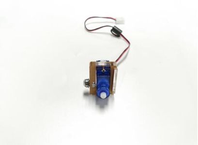

Step 4: Claw
Robotic Arm learn more

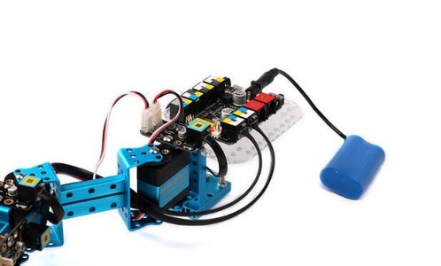

Step 5: Wiring

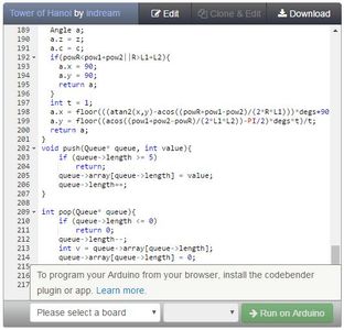

To program your Arduino from your browser, install the codebender plugin or app. Learn more.
#define MeOrion_H
#include
#include
int value = 0;
String buffer = "";
double angle_rad = PI / 180.0;
double angle_deg = 180.0 / PI;
MePort armPort(3);
MePort clawPort(6);
MePort panPort(4);
Servo servo1;//inside
Servo servo2;//outside
Servo servoTilt;
Servo servoClaw;
Servo servoPan;
const double L1 = 100.0; //armLength,inside
const double L2 = 170.0; //armLength,outside
struct Angle
double x;//inside
double y; //outside
double z;
double c;
struct Queue{
int array[5];
int length;
void pushPoint(Angle p);
Angle pointToAngles(float x,float y,float z,float c);
void addPoint(float x, float y,int pen);
void push(Queue* queue, int value);
int pop(Queue* queue);
void parseBuffer();
float prevX;
float prevY;
float prevZ;
float prevC;
long lastTime = 0;
long runTime = 0;
int len = 0;
boolean isRunning = false;
Angle currentAngle;
Angle lastAngle;
Queue hanoi[3];
float degs = 180.0/PI;
int posY = 220;
int posW = 100;
int openClaw = 80;
int closeClaw[3] = {150,130,110};
int tilt[4] = {100,110,120,130};
void setup() {
Serial.begin(115200);
delay(100);
servo1.attach(armPort.pin1());
servo2.attach(armPort.pin2());
servoTilt.attach(clawPort.pin1());
servoClaw.attach(clawPort.pin2());
servoPan.attach(panPort.pin1());
servoTilt.write(tilt[3]);
servoPan.write(90);
hanoi[0].length = 0;
hanoi[2].length = 0;
hanoi[1].array[0] = 3;
hanoi[1].array[1] = 2;
hanoi[1].array[2] = 1;
hanoi[1].length = 3;
addPoints(0,220,20,100);
delay(5000);
void loop() {
if (Serial.available()) {
char c = Serial.read();
if (c == '\n') {
parseBuffer();
} else {
buffer += c;
translate(1,2,0);
delay(2000);
translate(2,0,1);
delay(2000);
translate(0,1,2);
delay(2000);
void parseBuffer() {
buffer = buffer + "/";
int count = 0;
int startIndex = 0;
int endIndex = 0;
int len = buffer.length();
if (len < 1) {
return;
String tmp;
String values[6];
while (true) {
startIndex = buffer.indexOf("/", endIndex);
endIndex = buffer.indexOf("/", startIndex + 1);
tmp = buffer.substring(startIndex + 1, endIndex);
values[count] = tmp;
count++;
if (endIndex == len - 1) break;
if (values[0].equals("pos")) {
addPoint(values[1].toInt(), values[2].toInt(),values[3].toInt(),values[4].toInt());
buffer = "";
void translate(int from,int to,int other){
moveTo(from,to);
moveTo(from,other);
moveTo(to,other);
moveTo(from,to);
moveTo(other,from);
moveTo(other,to);
moveTo(from,to);
void moveTo(int fromPos,int toPos){
float x1,y1,z1,x2,y2,z2,z3,c1,c2;
y1 = posY;
y2 = posY;
x1 = (fromPos-1)*posW;
x2 = (toPos-1)*posW;
z1 = tilt[3];
z2 = tilt[hanoi[fromPos].length-1];
z3 = tilt[hanoi[toPos].length];
c1 = openClaw;
c2 = closeClaw[hanoi[fromPos].array[hanoi[fromPos].length-1]-1];
addPoints(x1,y1,z1,c1);
addPoints(x1,y1,z2,c1);
addPoints(x1,y1,z2,c2);
addPoints(x1,y1,z1,c2);
addPoints(x2,y2,z1,c2);
addPoints(x2,y2,z3,c2);
addPoints(x2,y2,z3,c1);
addPoints(x2,y2,z1,c1);
push(&hanoi[toPos],pop(&hanoi[fromPos]));
void addPoints(float x,float y,float z,float c){
int len = 12;
for(int i=0;i
float tx = prevX+(x-prevX)/len*i;
float ty = prevY+(y-prevY)/len*i;
float tz = prevZ+(z-prevZ)/len*i;
float tc = prevC+(c-prevC)/len*i;
pushPoint(pointToAngles(tx,ty,tz,tc));
prevX = x;
prevY = y;
prevZ = z;
prevC = c;
void addPoint(float x, float y,float tilt,float claw)
servo1.write(x);
servo2.write(y);
servoTilt.write(tilt);
servoClaw.write(claw);
delay(50);
//Serial.println("ok");
void pushPoint(Angle p){
if(lastAngle.x!=p.x||lastAngle.y!=p.y||lastAngle.z!=p.z||lastAngle.c!=p.c){
addPoint(p.x,p.y,p.z,p.c);
lastAngle = p;
Angle pointToAngles(float x,float y,float z,float c){
long pow1 = L1*L1;
long pow2 = L2*L2;
long powR = x*x+y*y;
double R = sqrt(powR);
Angle a;
a.z = z;
a.c = c;
if(powR L1+L2){
a.x = 90;
a.y = 90;
return a;
int t = 1;
a.x = floor(((atan2(x,y)-acos((powR+pow1-pow2)/(2*R*L1)))*degs+90.0)*t)/t;
a.y = floor((acos((pow1+pow2-powR)/(2*L1*L2))-PI/2)*degs*t)/t;
return a;
void push(Queue* queue, int value){
if (queue->length >= 5)
return;
queue->array[queue->length] = value;
queue->length++;
int pop(Queue* queue){
if (queue->length <= 0)
return 0;
queue->length--;
int v = queue->array[queue->length];
queue->array[queue->length] = 0;
return v;
