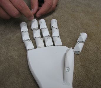

Step 7: The Palm and Forearm
I cut a triangular piece of the 1x4 scrap, pre-drilled holes and used sheet rock screws to attach it to the bottom of the hand in the thumb 1st joint spot. Don't skip the pre-drilling step or you will split the wood! Think about the angle you want the thumb to work toward that palm and how far that joint folds under when you fold your own thumb under. Look back at the part of the thumb you cut out on the template to get an idea.
Once I screwed this piece to the hand I used the 4" side grinder to shape and smooth the entire piece. You need to cut a 45 degree flat on the underside of where the fingers attach. This slope will mate up with the slope on the first bone segment of the fingers. You also need to grind off a slope on the inside of the thumb attachment point. Just think again about where the holes are going to line up with the finger joints. Remember that the flat part of the bones must rest against a flat spot on the hand when the fingers are straight. The sloped parts of the joints must rest against the sloped part of the hand when the finger is folded.
Next Sydney laid all the pieces out to check the fit. We selected the best joint pieces for the first joint of each finger. We labeled that end of each joint so we could make sure they stayed in the right spot. We used I-index, M-middle, R-ring, L-little. We spaced out these first joints so they looked right on the hand and marked the center of each hole on the hand. I used a set punch to mark the ligament holes on the flat surface (not the sloped part!) of the hand piece. The set punch keeps the drill bit from wandering as it starts to bite the wood. Then I drilled the holes from the inside toward the outside of the hand. The holes came out right behind where the knuckles would be if you made a fist. Be sure the holes slope as much as possible toward the elbow. This will allow the ligaments to pull smoothly and hold the finger joints together.

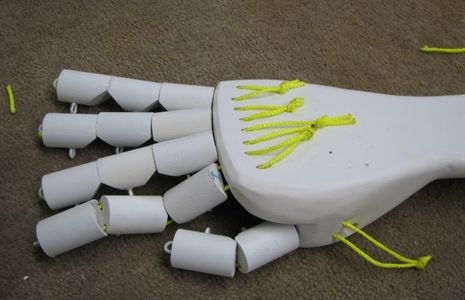

Step 8: Ligaments and Tendons
Drill a pilot hole on the inside near far end of each joint piece (except the finger tips) and screw in the small eyelets. The finger tip pieces get an eyelet closer to the inner slope - just inside of center. Drill a pilot hole in the center of the end of the fingertip and add the eyelets. Check out the pictures and notice the orientation of the eyelets for each spot.
We decided to add eyelets and tendons to the back of the fingers on this version of the hand. This makes it more complex, but more realistic. If you place your ligament holes just right they will hold the fingers straight so the top tendons won't be necessary. If you decide to add them, or have to add them because some fingers won't stay straight, then pre-drill and add the eyelets. We experimented with the positioning and it is pretty critical. Put the eyelet in the first finger segment close to the far joint. Put the eyelet in the middle of the middle segment. Put the fingertip eyelet close to the inside of the segment. Experiment on your own. Your design may vary.
Tie a piece of fishing line or your nylon string tightly to some upright in your shop and string the finger segments on it. Pull it really tight and tie it off. Separate the pieces on the string and paint away.
Step 9: Some Assembly Required
Lay out your pieces to test the fit. We folded the end of a paperclip over tight enough that it would easily pass through the holes. Then I cut off the end on a sharp angle to make a hook. Burn the end of your nylon string so it won't fray. You will need to do this after each cut.
Push the hook thorough the 1st hole and hook the ligament string. Use pliers to pull it back through. Be careful with your free hand so you don't get hook your skin. Feed the ligament through the hand out the finger, across the tip, back up the finger and through the hand. Feed the string through a rubber band then tie each ligament in a knot to make a loop that ends around the center of the back of the hand. Pull the rubber band tight and see how much tension it takes to hold the finger straight. String the ligaments for the rest of the fingers. Pull each rubber band to find which finger takes the most force to hold it straight. Mark that spot and pre-drill a hole and screw in the cup hook (obviously on the back of the forearm). Pull all the ligament rubber bands tight and hook them over the cup hook.
Start by stringing the tendons on the top of the hand first. Tie to the fingertip eyelet first. Feed it through the eyelets on the middle and first finger segments then through a rubber band. Feed it back through the eyelet on the first segment and temporarily tie it to the middle segment eyelet. Leave some slack and don't make this knot permanent until you have run the inside tendons and tested everything. Hook the rubber band around the cup hook. The top tendon rubber bands should barely be tight at all.

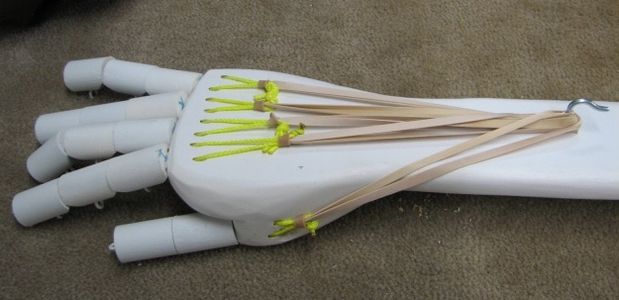

Fold each finger and notice where the fingertip hits the palm. Mark this spot for each finger, pre-drill and install an eyelet. Tie a tendon string to the fingertip eyelet and feed it back through the rest. Tie all the inside tendon strings together near mid-forearm. You might want to attach a single rubber band to this group of strings and pull them lightly to an eyelet at the elbow. This will keep the inside tendon strings from getting tangled and make them easy to grab separately.
Step 10: It's Really Fun/Weird to Play With!
With very little practice, you can make it do all sorts of hand signs. It's also really weird feeling to shake hands with it.
You don't have to paint the hand, but it looks a lot nicer. After painting white you can draw the carpals and forearm bones (radius and ulna) on the back of the hand/forearm piece with a sharpie. Then you can paint in (black) all the parts that aren't bone and the finished product will look more like a skeleton - for science fair purposes as least. The student should include some pictures of themselves cutting the pieces and building the hand. If you paint the hand to show the bones then you can label them and call them out on their info foam board. By using different colors for the ligament and tendon strings you can easily call them out in the documentation too.
Kaitlin wants to do a more advanced hand for her high school project. We are talking about using copper water pipe, soldered joints and maybe muscle memory wire for the tendons. If that works out I'll post the project. (EDIT: I just posted a couple of pix of Kaitlin with her original hand and her prize ribbon.)
The hand was a BIG hit with the students and teachers at both Kaitlin and Sydney's schools. Their friend and uncle are a pretty big hit with these two girls too. I enjoyed teaching them about tools, shop safety and *making* interesting things that you dream up yourself.
