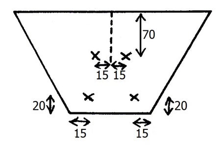

Step 8: Making the Soundboard
(1) Cut the cardboard rectangle so that it tapers symmetrically from 380 mm wide at the top to 130 mm wide at the bottom (see diagram).
(2) Poke four holes in the cardboard with the point of a pencil, at the positions shown in the diagram.

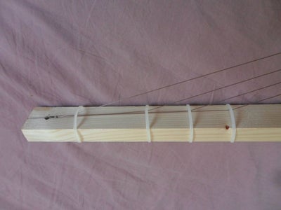

Step 10: Adding the Tuning Mechanism
(1) Look at the close-up of the finished harp to see how cable ties are fitted around the strings. Fit a cable tie around one end of the string that’s lowest on the bridge, pull fairly tight and slide it to about 200 mm from the end of the wood. Then do the same with a cable tie at the other end.
(2) Now fit a cable tie around one end of the next lowest string. Pull fairly tight and slide it to about 150 mm from the end of the wood. Then do the same with a cable tie at the other end.
(3) Do the same for the next string, sliding the cable ties to about 100 mm from the ends of the wood.
(4) Do the same for the next string, sliding the cable ties to about 50 mm from the ends of the wood. If you want, trim off the ends of the cable ties.
Step 11: Ready to Go
Adjust the pitches of the notes by sliding the cable ties along. You should be able to get a scale – do, re, mi, fa, so, la, ti, do – with the notes alternating from one side to the other.
