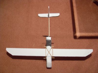

The first thing we do is measure up the dowel. it gives us a rough idea where everything is going to be spaced out. it also makes it easy to put everything in place,. The pod of the plane is 200mm long, the wing is mounted on top of the canopy so it takes no dowel space, The tail plane (rudder and elevator takes) up 50mm of the end of the dowel. For a sense of component size, mark the pod size and tail plane size on the dowel like in the picture. zoom in to see the markings more clearly.
Step 3: Measuring and Cutting the Main Wing Basic Shape
The wing is 900mm long and 75mm wide. First cut a rectangle to these dimensions. we will shape e wing in a later step.
Step 4: Measuring and Cutting the Tailplane Basic Shape
The two elevators are 150mm long and 5mm wide. The Rudder is 150mm long and 150mm wide. remember that this is only the basic shape, and we will shape everything later.

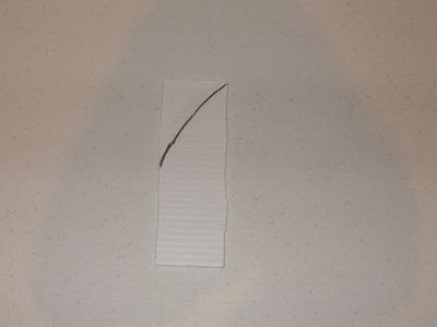

Step 5: Shaping the Wing
Now we are making the basic shape of the wing. A square wing looks boring and doesn't work too well.To shape your wing use a pencil to draw a curve from the top of the wing to the bottom edge which will work as your wing shape.
Play around with your design and be sure that it works. Next mark it on both sides with the permanent marker and cut it out.
Your wing is complete!!!

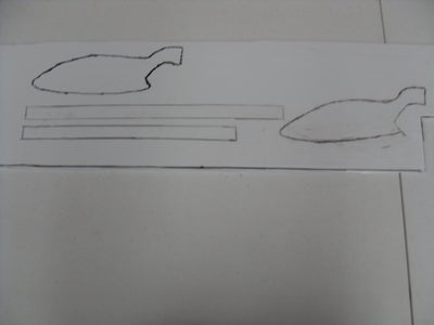

Step 6: Shaping the Tailplane
The tailplane consists of the elevator and rudder, to shape the elevator follow the same as you did for the wing.
when you are dong the rudder you must draw the design that is long at the bottom and has a normal wing shape towards the top.
As you can see I have shaped the wing in 3 steps. Don't forget that we are modelling our plane on the Hobbyking mini breezair, so the same shape should be used in the tailplane.

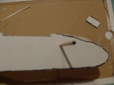

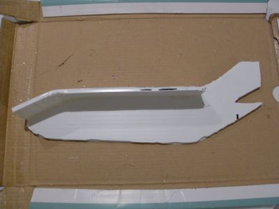

Step 7: Designing & Cutting the Pod

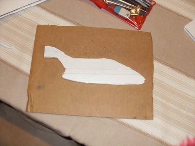

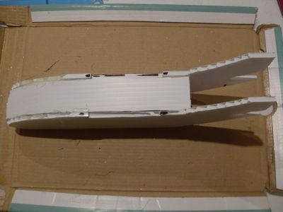

For a pod and boom styled glider, the 'pod' is the main cockpit where the electronics are housed. The glider is powered, pusher style (the motor is facing the back of the plane and 'pushes' the plane along). Therefore, the motor mount is designed for the cockpit. The pod is 200mm long, and 100mm high at the motor mount .

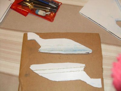

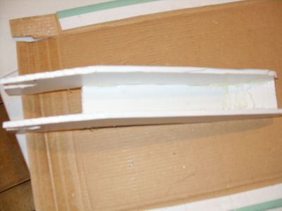

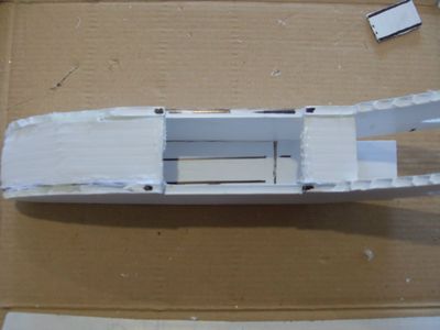

I made 8 different pod halves. I made 2 whole pods and 2 draft halves. the first pod was my original design. the first draft helped with bending practice, the second draft was my straight draft to see how much space there would be and how it would look. The second pod is my current design which has a more streamlined shape with a better motor mount connection. you can see that along with the pod halves there is also 2 long strips of corflute. Those strips are for joining the pod together. it is important to have the strips of adequate width, as the length does not matter too much. My strips where 35mm in width with varying lengths. The width is the most important, as the pod needs to be wide enough to house the electronics and ensure it fits in comfortably. preferably make the joining strips to fit in 3-4 parts, the top, bottom, back and over the A curve in the pod is optional, not necessary. My first pod had a bend and also a joining strip that was not wide enough, therefore I had to make another one, I saw the FT Simple soarer, which has a flat canopy. I used an adaptation of the FT Simple soarer for the pod of the plane, originally I made a curved pod but it didn't work too well, so I used a Flat Pod instead. Don't forget to use pencil to mark before you use permanent marker and cut. When curving the strip to join the pod, if you are using corflute, it is best to shave off one flute sheet as shown in the picture. It will take quite a while but the result is worth the effort as it will make the bending process easier.
Step 8: Putting the Pod Together

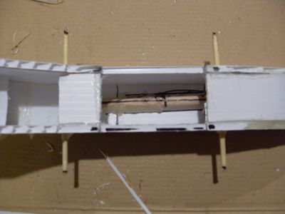

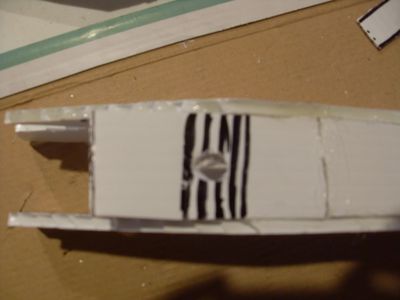

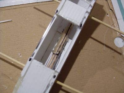

First you take one of your pods and a joining strip and glue them together on the edge as shown. Because The wing is our access point to the inside and electronics, it will need to be removable and completely flush. Before you connect your pod together, you need to mark where you will be cutting a groove in the pod for the wing you will need to settle the wing. To do that, using a permanent marker mark the width of the wing where you want to cut the joining strip away. cut between. make sure to look to the pics for help as they have a lot of useful notes.
to put the skewers through, first mark where you want it, then drill through with bit that fits your skewer size, also put the skewers through at a length of 20mm long from the pod wall on each side to make sure that the bands will stay connected.

When making the motor mount plate I used a wooden coaster (the ones you use to stop a glass from scratching a table) that I found at my local bunnings( if you live in Australia), marked it out and cut it to size using a hacksaw blade. it is important to use a drill-bit that is one size smaller than your screw size, as the coaster has no thread and the mount needs to be firmly fastened. I do NOT recommend glueing the motor mount to the plate because when screwed you can always remove it and use it for another project, whereas if you glue the mount to the plate you will be stuck with it (get it?).

Your Done!
