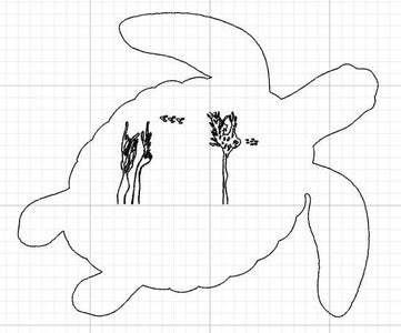

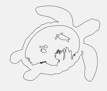

We decided to build the scene using three layers, with an engraved background on the back panel. The sea turtle would form the outer frame of the shadowbox. We also added spacer layers between each cut layer and the back panel to enhance the box’s depth.

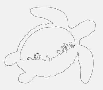

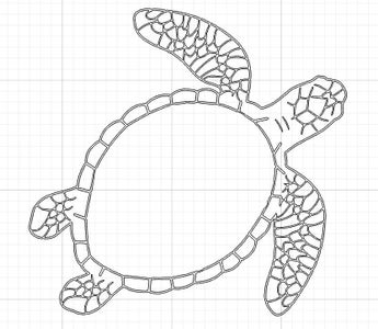

Step 3: Design
We edited the turtle profile by erasing everything inside the shell and used the tracing feature in Creative Space to create a vector from the edited image. We created one copy of the turtle without the lines to be the spacer layers.
Initially, I planned to scan and import her drawings directly into Creative Space and combine them with the turtle profile. However, I struggled with this process and ultimately used AutoCAD to digitize the hand-drawn elements with the spline tool. In hindsight, the current version of Creative Space likely would have handled the task, but I couldn’t make it work with the older version.

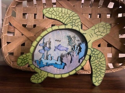

We painted the scene and the turtle using watercolor paint to bring it to life.
Step 6: Assembly and Finishing
Use wood glue to assemble the layers. We glued two layers at a time, allowing them to cure overnight under weight. Once dry, apply two coats of clear coat to seal and protect the piece.
