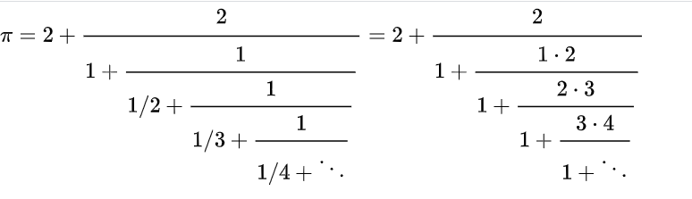

In December 2008, a new continued fraction for Pi was proposed, involving radicals:
  • The numbers in front of the 'plus' sign are the inverse of the integer numbers: 1, 1/2, 1/3, 1/4, etc
  • The number over the fractions is always 1
If you want to try it, just use:
def CF (n):<br>    # number before the plus sign    a = 1/(n+1)    # numerator of the fraction    b = 1    return a,b
and run the script. The answer is
Continued Fraction = 0.5707963267956820
which is Pi / 2 - 1 with 12 exact decimal places. The search provides:
