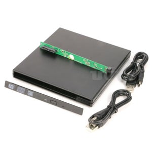

Step 4: Make External DVD Drive From the Old Optical Drive
Now, we're going to install the old DVD Drive into an enclosure. First, you need to ensure the front bezel of the DVD drive is installed. (The bezel is included in the enclosure).
Gently pull the enclosure and it will split into 2 parts. Place the DVD Drive and the connector into appropriate position. Install the cover back. There are 3 screws supplied to secure the DVD drive inside the enclosure.
