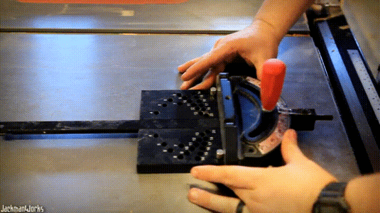

For cutting out the segments I use the miter gauge and set it at the right angle. For this I did 12 segments per ring which works out to 15 degrees, but I used this new jig I got called the miter set which gets your miter gauge to the perfect angle, I love this little thing -- check it out here: http://miterset.myshopify.com/
I start by cutting out 12 segments from the cherry for a test ring.
To clamp these together I use a couple of hose clamps. First I dry fit and the segments fit tight so I proceed to cut the rest of them.

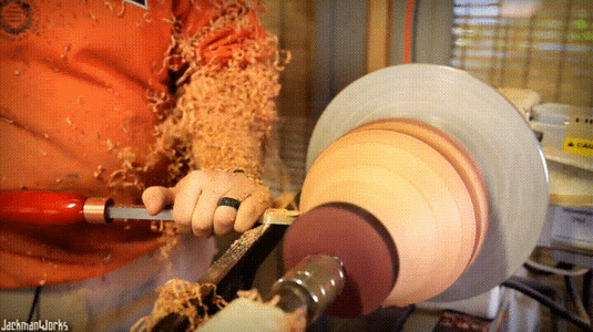

Once dried, I pull the clamps off the rings and mount them in the lathe to take most of the roughness and glue squeeze out off the rings.
I use a straight edge to make sure the rings are flat while I smooth them out.
Then the surface of the rings are brought down finally using a sanding disk attached to a piece of melamine which keeps it flat.

Once the 2nd glue-up is dry, I mount the bottom halves in the lathe to shape.
I start by shaping the bottom hole where the plug will fit.
The plug is then shaped down to until it fits inside the bottom of the urn.
Now that I can pin the urn between centers on the lathe I temporarily attach the two halves of each urn together using double sided tape.
The shavings start flying now! The outside is brought down round and to rough shape.

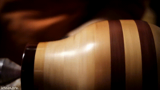

I then mount the urns back in the lathe for final shaping by mounting it from the hole in the bottom. The cherry cuts so nice, lots of curlicues flying around!
For a bit more shape and accent to the top I decide to add some rings. I use my calipers to to scrape a bunch of even lines in the top, then trace those with a pencil to better define them.
I use a detail tool to carve out the rings in the top.
Then I sand through the grits down to 220.
