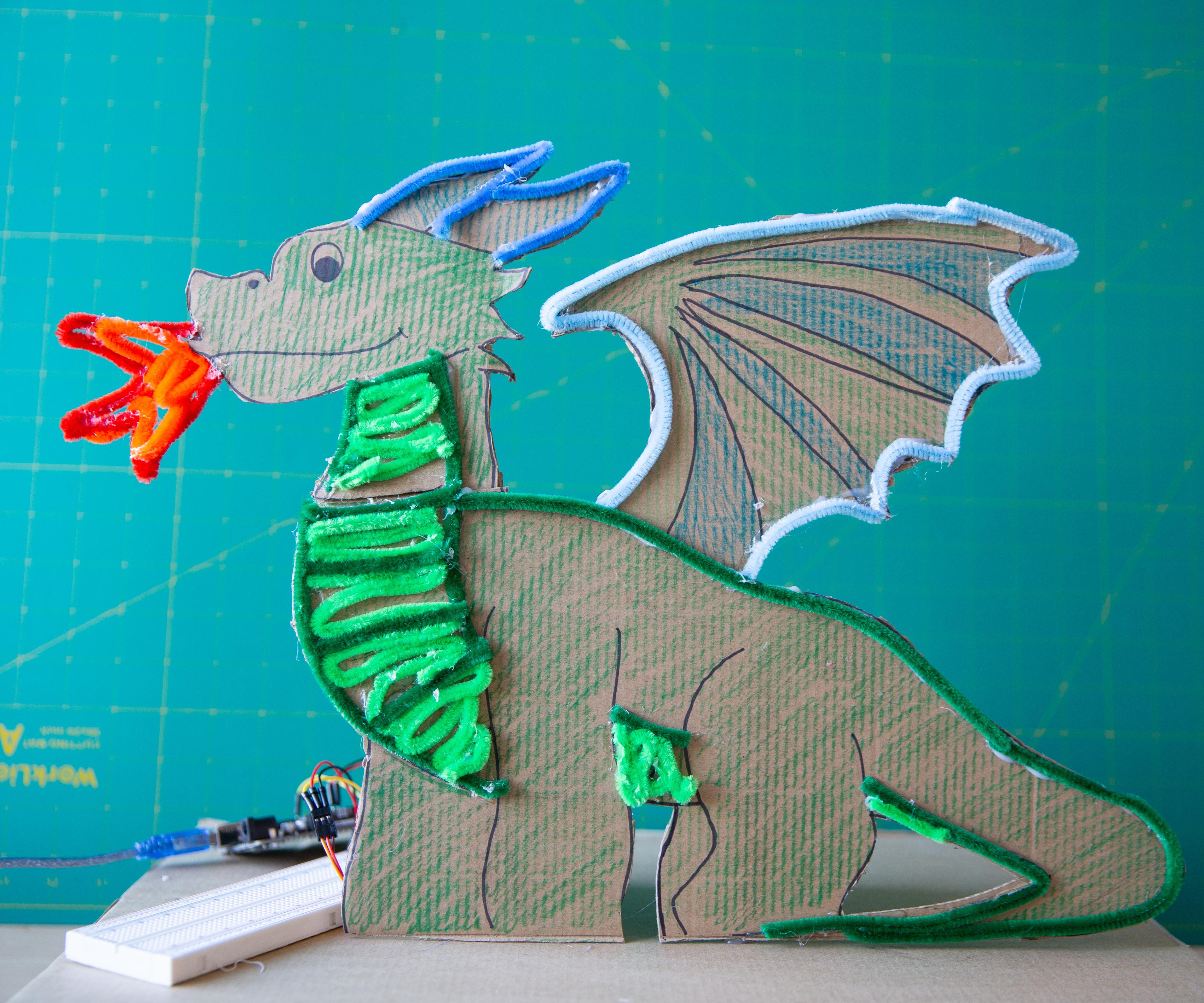

Now that we have explored sensors and how the Arduino can use them, we will use one of the sensors to extend the functionality of the follower leg built in the Leader Follower Robot Leg project. Check it out here (https://www.instructables.com/Leader-Follower-Robot-Legs/) if you have not already completed that project.
Step 9: Brainstorm an Idea
The first step in extending the Follower Leg is deciding what we want to do. Think about the types of things each sensor would allow. The ultrasonic can output distance measurements, the temperature and humidity sensor can give you information about the weather, the photoresistor can tell whether it's exposed to light.
Once you have thought about the sensors you would like to use, you may also want to think about what the leg could do in response to that information. For example, the leg could be set to a certain position, it could wave, or it could move at a certain speed in response to a sensor reading. Instead of using the leg, you could also just control a servo and/or LEDs directly.
For this project, I chose to use the ultrasonic sensor to make the leg wave whenever someone moves by it.

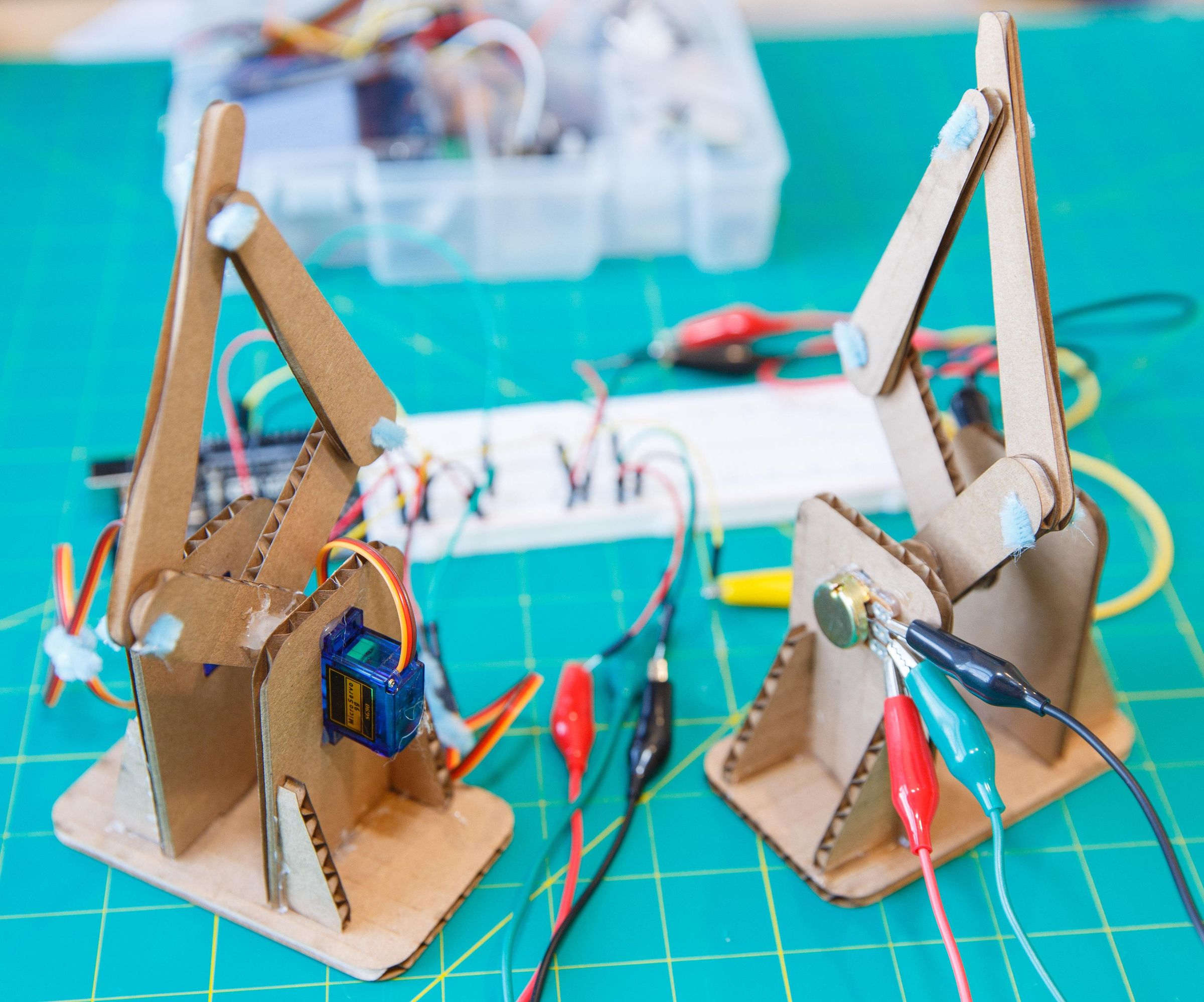

Step 10: Review of the Follower Leg
As a reminder, the Follower Leg is controlled by two servos. By changing the position each servo motor is set to, you can change the orientation of the leg.
The circuit diagram above shows how you would wire up the servo motors. The red wires are connected to the 5V pin of the Arduino and the brown wires are connected to the ground pin. The yellow wire is connected to a Digital PWM pin (pins 9 and 10 for the two servo motors).
You should be able to move the follower leg with code provided in the Leader-Follower project linked above.
