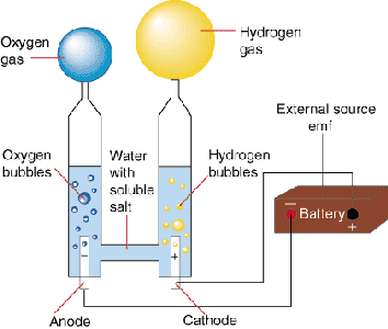

Step 1: Electrolysis of Water - an Explanation
This section is an explanation of the electrolysis of water, feel free to skip it if you don't find it interesting.
2H2O(l) = 2H2(g) + O2(g)
As everyone knows a water molecule is formed by two elements: two positive Hydrogen ions and one negative Oxygen ion. The water molecule is held together by the electromagnetic attraction between these ions. When electricity is introduced to water through two electrodes, a cathode (negative) and an anode (positive), these ions are attracted to the opposite charged electrode. Therefore the positively charged hydrogen ions will collect on the cathode and the negatively charged oxygen will collect on the anode.
When these ions come into contact with their respective electrodes they either gain or lose electrons depending on there ionic charge. (In this case the hydrogen gains electrons and the oxygen loses them) In doing so these ions balance their charges, and become real, electrically balanced, bona fide atoms (or in the case of the hydrogen, a molecule).
The reason this system isn't very efficient is because some of the electrical energy is converted into heat during the process. There have been reports of 50%-70% efficiency, but I doubt that is possible in a home environment. Anyway, enough with the boring stuff, lets go make some gas!

Ok, this is the tricky part. You need to flip the gas collecting container(s) upside down in the med. container, so that no air is trapped in the gas container(s). I do it by holding my thumb over the hole, and flip it really quickly. Its not a huge deal if air is trapped, your hydrogen just won't be pure.
Step 5: The Electrodes
Now take the two electrodes leading from your power source. The hydrogen will form on the positive electrode, and the oxygen on the negative. If you don't know which is which, turn on the power source and stick the electrodes in the water. The one with more bubbles is the hydrogen. Now stick the electrode underneath the gas collecting container. (turn off the power first) If you're having trouble making the gas collecting container stay up, and the electrode stay in the right place, tape it. Thats what I do anyway.
Step 6: Thats It!
Thats it! Turn it on, and watch it bubble. The amount of time it takes depends on how powerful your power source is. Stronger it is, faster it bubbles. Mine takes about 5 min for a test tube.

So... probably an off-topic question (or five), but here goes. Let's say the diagram is a literal representation of the mechanism. After a certain amount of time, both the H balloon and the O balloon will begin to inflate and cause backpressure. Is there a ratio of pressure gains between O and H during electrolysis? Does that ratio change after adding electrolyte to the solution? And if the ratio is constant, couldn't we could build tanks that could stay balanced? As long as that center connection between the tubes stays full of water, then each side will maintain its integrity, right? Which begs the question: Does electrolysis slow as pressure increases? I feel like a 5-year-old who just learned how to ask questions.

Normally the electrode connected with negative terminal of battery is used to collect Hydrogen but here it is collecting Oxygen?
