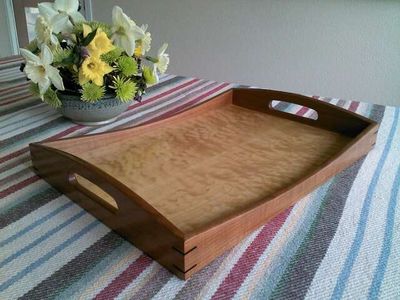

This serving tray is made from cherry and big leaf  curly maple veneer, but could be made from any combination of hardwoods. The overall size is 14 ¼” wide and 19” long. The height is 2 ¾”. The thickness of the sides is ½”. The bottom panel is 3/8” thick.

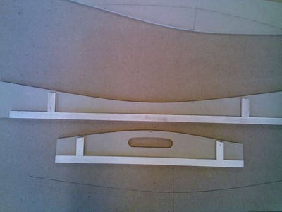

This project requires making 2 templates to shape the sides of the tray.
