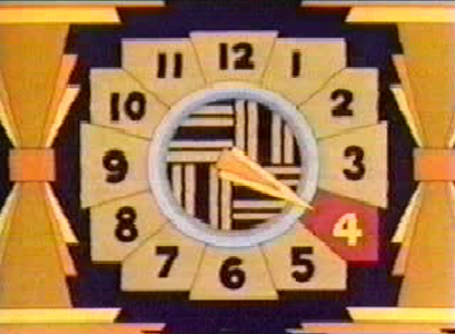

Step 1: Design Choice
Having grown up in the era; Sesame Street was a big part of my life. It was all forgotten until Family Guy did a reference to the Pinball Number Counting animated segment in the episode The Father, the Son, and the Holy Fonz.
YouTube video of the segment (not uploaded by myself)
After watching it numerous times, the idea to make a real clock from the image popped into my head.

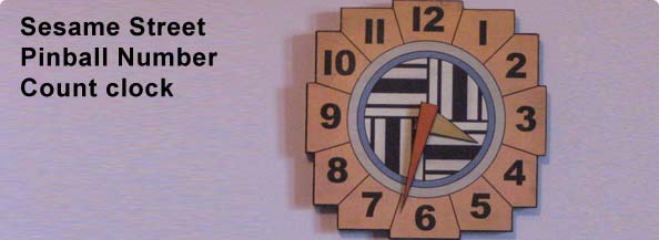

Step 4: Construction - Cutting the Basic Shape.
Start by affixing a copy of the printed clock face on to the wood, masking tape was used. Begin jig-sawing the shape, making sure to stay outside the lines. Cutting on the outside of the lines allows for precise filing however, this doesn't work the other way.
With the basic shape cut, affix another copy of the printed clock face that has been cut out. This will give good practice on using the spray adhesive. The edges can then be filed.

Step 6: Construction - Painting and Applying the Printed Graphic.
Once the shape is prepared and finished the presentation can be worked on.
The edges need to be painted to match the clock design. If the wood is a fairly dark colour but the design is bright then the wood needs to painted white or a lighter colour.
A wood primer was used first (this is the white coat seen in the pictures) then followed by a black coat on the edges as this matched the outlines of the design.
To stick the printed paper to the wood, first cut it out. Practice placing the paper onto the wood trying to get the alignment as accurate as possible. Once ready, spray contact adhesive onto the back of both surfaces, wait till it becomes tacky and then apply the surfaces together. Use a rag to press the paper making sure there are no bubbles or creases.
Once dry, a final clear coat can be applied if desired.
Step 7: Construction: Hands and Wall Hanger.
Clock hands
The clock hands are quite straight forward. After being printed out the hands were glued to very thin aluminium with the contact spray adhesive. Cardboard or plastic could easily be substituted; it does however need to be light weight. The aluminium was thin enough to be cut out with scissors once the glue dried.
Prepare the original plastic clock hands by sanding the outer sides flat. Now it is simply a matter of gluing the hands to the aluminium with epoxy. Make sure they are in the centre. The little hand (being below the long hand) will need to be drilled; the existing hole can be used as a guideline.
Wire wall hanger
To hang the clock, a simple wire hanger was created with picture hanging wire and screws. The make the screws flush, the holes may be counter sunk. A 3M 2kg hook was used on the wall.
Wire wall hanger
Step 8: Final Completed Pictures.
Final pictures of the clock hanging on my wall.
