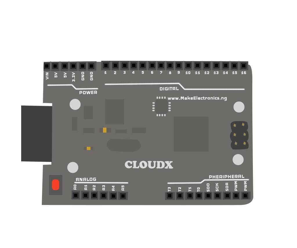

So, you've just bought, or are considering buying, an CloudX Starter kit. Your mind is probably full of questions about how and what you can get started right away maximizing your experience. Nothing is stopping you from coding the next big thing. To help you on get started without anyone's help or guide, this article will cover required software downloads, driver installation and device configuration. This should be enough to get you running and exploring!

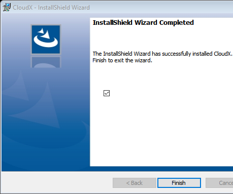

The CloudX Software Editor is a programming environment just like Notepad++ that allows you to write your codes and highlights recognized CloudX C syntax, pre-processor libraries with auto-complete feature. With the CloudX software editor, programming errors is reduced to less than 3% so it makes it more fun for hobbyists to write codes without any bug. Click to download the CloudX Editor Software and install the setup on your computer. To learn more on the CloudX editor click here
