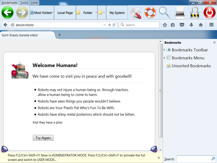

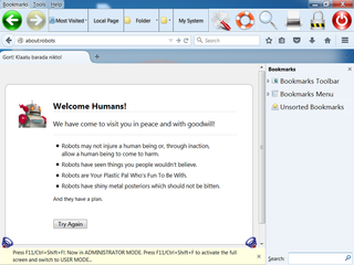

7 years ago
Try to use mKiosk firefox plugin - https://addons.mozilla.org/addon/mkiosk/ - Public Firefox Kiosk Mode with optional Tabs Guides for Access Point. Complete solution. Block downloads/addon, bookmarks, reset kiosk inactivity, retry on errors, restricted interface, show favorites as buttons and more...
