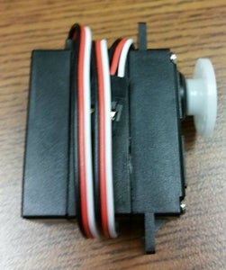

Step 22: Remove the White Circular Attachment From One Servo
Get out one servo. Remove the white circular attachment from the servo by unscrewing it.
Step 23: Attach the Servo Without White Attachment to the Bracket
Attach the servo without the white attachment as shown with 4 of the screws and nuts from the servo mounting kit.
Step 24: Attach the Other Servo
Attach the other servo as shown in the image attached to this step.
