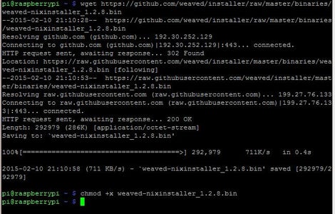

Step 3: Download the Weaved Software to Your Pi.
In the command line on your Raspbery PI, type the following command:
wget https://github.com/weaved/installer/raw/master/binaries/weaved-nixinstaller_1.2.8.bin
Step 4: Make the Weaved Software Executable.
We will make the installation file downloaded in Step 3 executable:
Again, in the command line:
chmod +x weaved-nixinstaller_1.2.8.bin

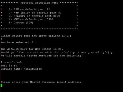

Step 6: Choose a Service.
When you first start, you’ll be asked to install one of the Weaved services: SSH on port 22, Web (http) on port 80, WebIOPi on port 8000, VNC on port 5091 (tested with tightvncserver), or A custom TCP service on your port of choice.
In this example, we'll choose the second option, http on port 80.
Step 7: Enter Your Weaved Login Information.
Enter in the information we setup in Step 1
Be sure: not your Raspberry Pi login information, but the information for your weaved account (which you setup in Step 1!).

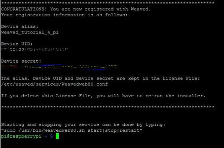

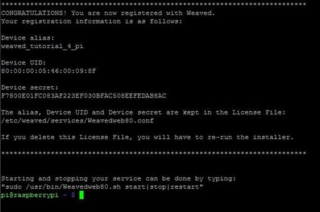

You’ll be prompted for a device name. Name your pi wisely . . .
For this experiment, we chose “weaved_tutorial_4_pi” . . . and success!

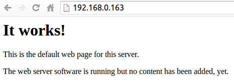

Step 8: Test It: Install a Webserver.
Everything for weaved should be setup properly at this point. We'll test it out by setting up a server on the Raspberry Pi to serve up web pages.
We won’t go into depth on how to do this. The Raspberry Pi foundation has a great tutorial for installing an Apache server on your Pi.
You can install Apache in two quick command line commands:
sudo apt-get update
sudo apt-get install apache2 -y

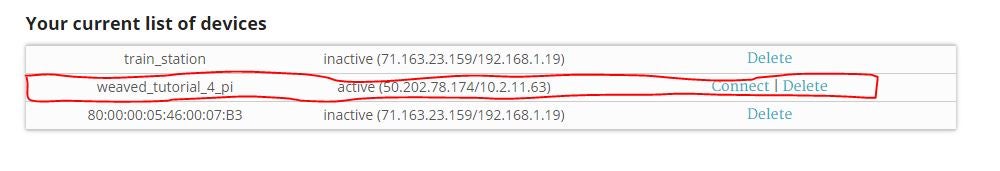

Step 9: Now, Let’s Check That the New Device Is Online.
Go to the Weaved developer console here. You may be required to login.
We can see that the device we just setup is usable and can be connected to!

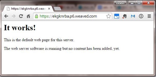

Step 10: Check Out Your Website.
In the weaved developer console, click “Connect” and a new window will be opened up.
It works! If we type in the address you see after https:// in the browser below, you can see it in your mobile phone, or from anywhere on the internet!
