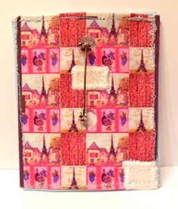

So, you see fabric photo frames in stores, and being sold by crafters on Etsy, & Amazon, yet ...you wonder how they could be sustainable, washable even? How about having them sewn? WELL...
I did it! I have invented 3 new ways to make fabric photo frames, 2 of which are WASHABLE!
In this instructable, you will see photos, a link to a video tutorial, plus photo & text step by step instructions on making washable, sewn, fabric photo frames.
2 sizes of washable, sewn, fabric photo frames from Kristie Hubler / Fabricated Frames, with washable fabric picture frame sewing pattern and tutorial, were featured in Sew It Today magazine, issue 11, August / September 2014 issue, page 55-59, titled "Framed", featuring Fabric Editions / Fabric Loft "Trapeze" collection, chevron and large medallion, available in Target.
