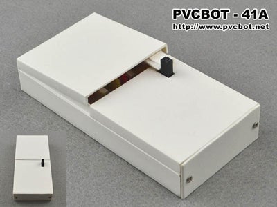

First picture shows what it is supposed to look llike

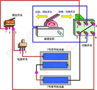

Second picture shows how the arm and switches work.
Third picture is the schematic which is pretty informative even though I don't read Chinese.
