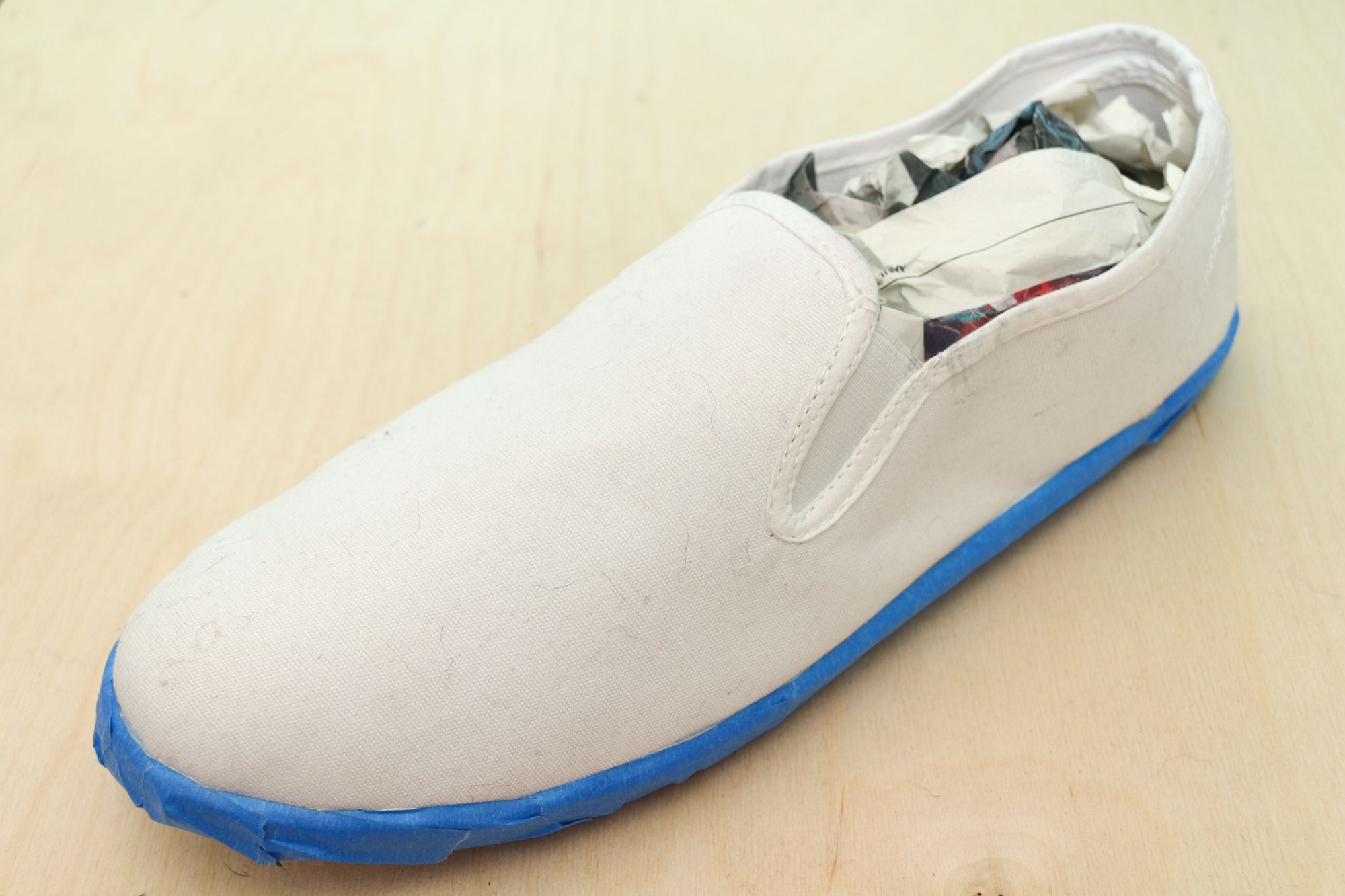

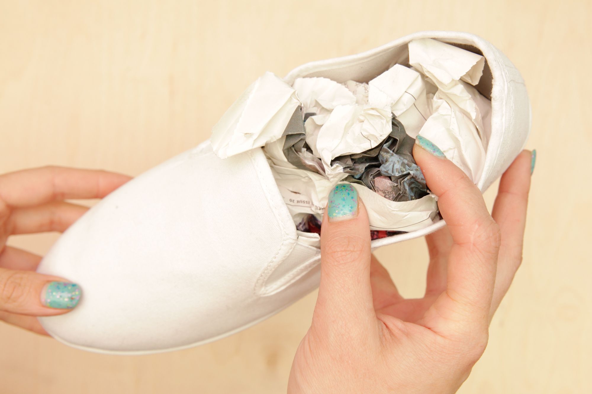

Start by stuffing the shoes with newspaper, this will create a rigid backer so the shoes' uppers don't bend or flex when you are trying to apply the glue or the fabric. I taped off the rubber sole so that I didn't accidentally get glue on them.

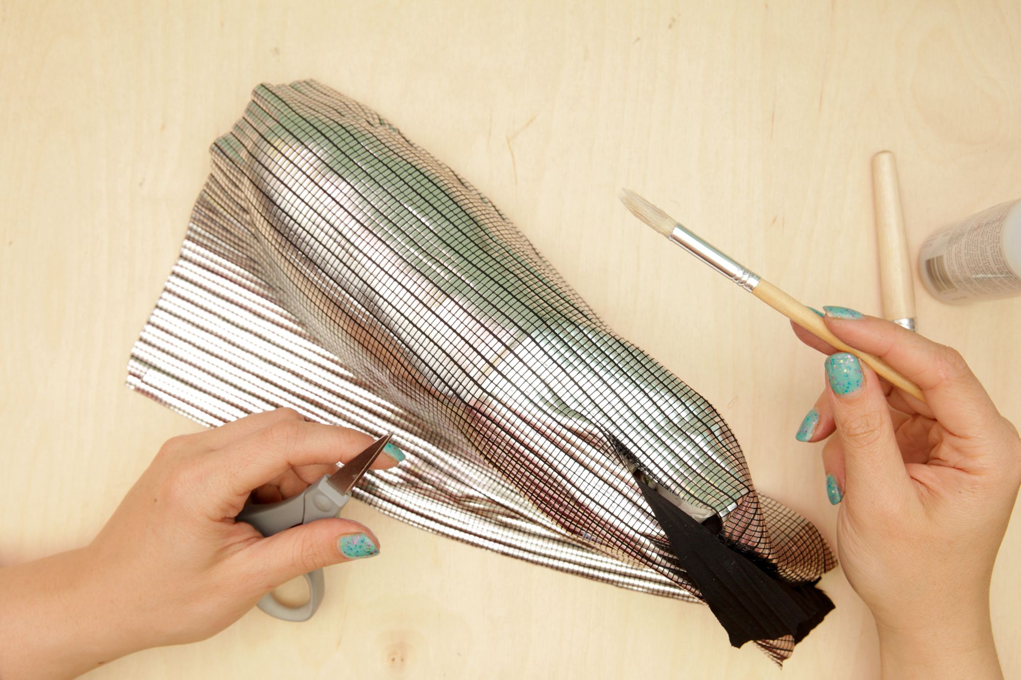

Using a brush, spread a thin layer of glue onto the canvas shoe as well as the fabric you are applying. The thinner the better, you may need to thin with acetone if your glue is too thick. Only thin a little bit at a time, otherwise, your glue can penetrate all the way through the fibers - which we don't want.
Slowly mate the two fabrics, make sure that there are no air pockets between the shoe and the fabric you are applying. Those air pockets can cause unsightly bubbles and may inhibit a model bond from being made. I like using a dry brush to push the air out.

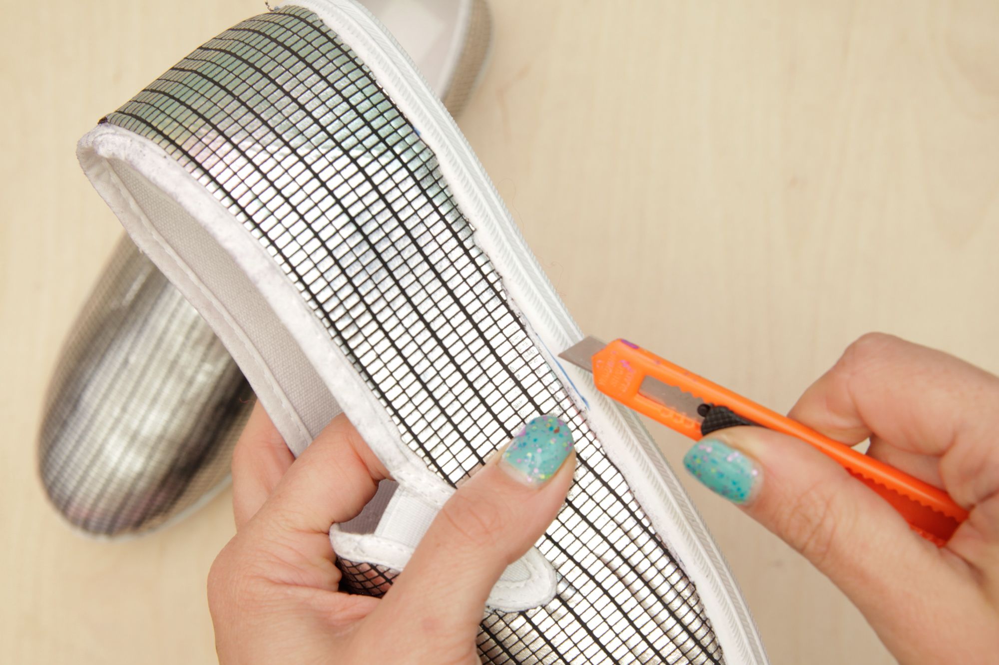

When the glue is completely dry (read the back of the bottle, but I would definitely wait at least a day before moving them.) Trim away all the excess fabric. Some areas may have lifted, and you can glue those back down. Make sure the shoe is completely dry before wearing - wait at least 24 hours after the final glue application.
