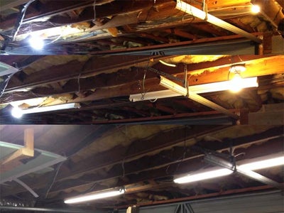

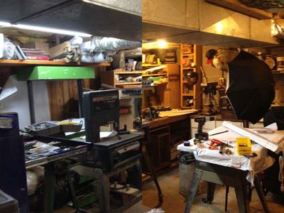

I have a Sketchup model of my shop, and measured out equal spacing for the new fixtures. With the garage door I had to keep the incandescent fixtures outside the path of travel, but the new fixtures aren't as deep so I can achieve better coverage.
I came across a lighting guide suggesting a minimum of 100 lumens per square foot for a shop. A 40-watt fluorescent bulb puts out about 2,200 lumens which means my upgrade increased my output to 26,400 total from 2,400. Incandescent bulbs put out 800 lumens. My new set up put me at 100 lumens psf, two more lights would hit 130. I'm coming from 17 lumens psf so it's a big upgrade. You can never have too many lights, but determine the square footage of your shop and make sure you get at least 100 lumens.
The layout of the existing lights wasn't far off. I just centered them in the room, though I did have to rotate the middle two fixtures to accommodate ducting.
I installed the junction boxes and lights before cutting power so I still had light to work. I had to rotate one of the center bay lights 90* due to ducting and rotated the other center bay light the same orientation for symmetry.

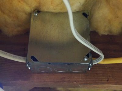

I tried to keep the junction box on one end of the light, but shifted a few boxes due to bracing or ducting and so that I wouldn't need more wire. Make sure your existing power wire will reach each junction box. If not, you'll need to run a new length of wire. I had to replace the run of wire to my last light, as it didn't quite reach and I misjudged the junction box location.

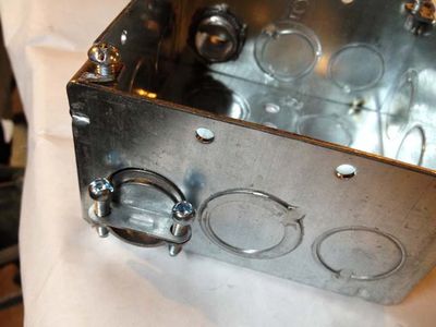

I placed the junction box 3/4" up from the bottom of the joist and marked two holes in the back of the box with a pencil. Drywall screws hold the box in place. You'll need one box for each light. Whenever you have a splice in wire, you need a junction box with strain relief. I didn't remove any knockouts yet.

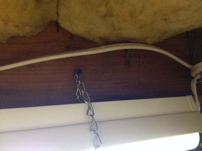

The lights are 4' long with the chain 6" inset at each end. I drilled the hole for the chain 1.5" off the bottom of the joist and screwed through the chain link with the light tight to the bottom of the joist. Doing this by myself, I screwed one end of the chain with more slack than I needed so I could screw in the other side and then readjust the first side. The lights are tight to the bottom of the joist, or have a minimal amount of gap.

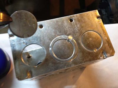

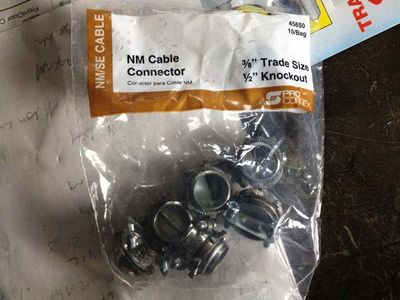

Remove the knockout and screw in a strain relief connector. For the knockout, I hit it with a hammer then use pliers to twist it off and out. To get the strain relief tight, I would have the screws of the strain relief at the top or bottom depending on side, tighten the nut by hand, then twist the connector to tighten it further. Run the light wire into the box through the strain relief Don't screw the strain relief down yet, as you still need to run power from the existing light.

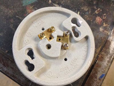

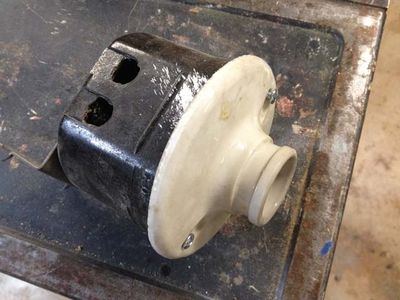

Remove the old fixtures, but don't cut the wires. I unscrewed the incandescent bulb fixture from the plastic junction box then removed the wires with a screw driver. A hammer and pry bar were used to remove the boxes which were typically nailed into the joist.

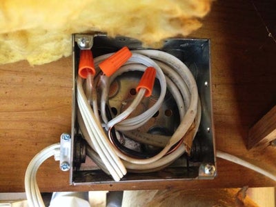

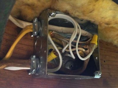

I ran the existing power wire and new light wire into just one knockout. That way I only use one strain relief connection per box. For my light that has the power coming in, I used two strain relief as I had the power wire, splits to two different lights, and the light fixture cord. That just wouldn't fit into one connection.
Run the wires through the strain relief opening and tighten it down. I make sure there are a few inches of slack in the wire from the light to the box. The strain relief ensure the wires will never be pulled out of the box or pulled apart. Without this, you have the potential for an electrical fire. The junction box is a further safeguard, to contain any shorts, sparks, etc. I've seen connections only taped, but wire nuts ensure the ends of the wire don't poke through the tape.
The existing wires should already be stripped, but you may need to clip the ends if they are too bent and strip further down the wire. I typically strip 1/2" off the wire, then I tape the two (or more) wires I'm connecting together with electrical tape, then twist them together slightly with pliers. Wire nut them. If you're just joining two wires, an orange wire nut is fine. If you're joining three or four, use a yellow wire nut. Connect the black wires to black, white to white, and ground which is typically a bare wire or green to the matching wire. While the light fixture has the ground wire in a green jacket, the other two wires are not color coded. With a house being alternating current, you can't wire the light wrong as long as you get the ground correct. Alternating current means electricity flows through both wires.
Make sure the wire nut is tight and sized correctly. You can always tape the wire nut, but I didn't. If it's sized correctly it will stay in place. Once everything is in place, put the wires into the box and screw the cover on. If the wires don't have good contact or the wire nut is loose, pushing the wires in the box could loosen the connection. That's why I give the wires a slight twist together before capping them. You'll have to force the wire into the box as it's solid strand, but that's okay.
