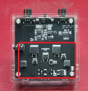

 The driver part is composed of several powerful SMD mosfets (two irfp and one irfp) which are mounted on a relatively massive aluminum heatsink.

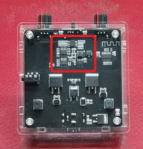

 The other part represents an interrupter plus an audio modulator consisting of two NE555 integrated circuits, then an LM339 comparator, and XL7005 Buck-Step down converter

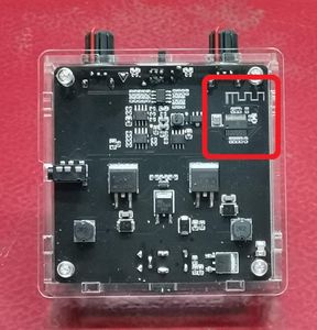

And this is a Bluetooth audio receiver for wireless, as well as an input audio jack for wired audio communication.

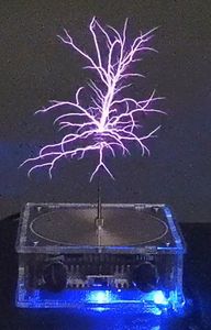

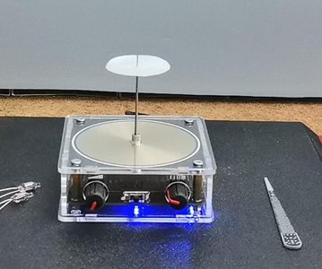

The spark is accompanied by a very loud sound that complements the excellent visual effect. The power is controlled with the left potentiometer, and the discharge frequency with the right. We can place different shapes on the needle to get interesting visual effects. Here's what discharge looks like through a thin circular disc.

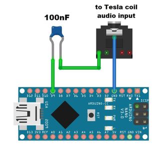

Next let's test the plasma sound option, noting that for proper functioning, we need to bring a so-called rectangular music signal to the input. For this purpose I made a very simple Arduino project that actually generates a melody with this type of signal.
This time we will not dwell on the Arduino project, and the code and scheme are given below in the project.
