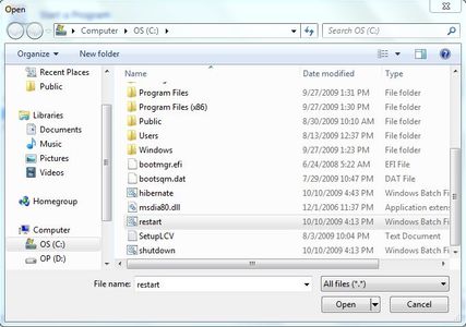

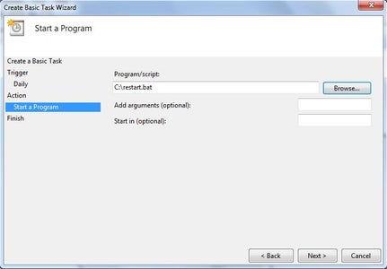

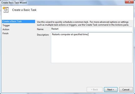

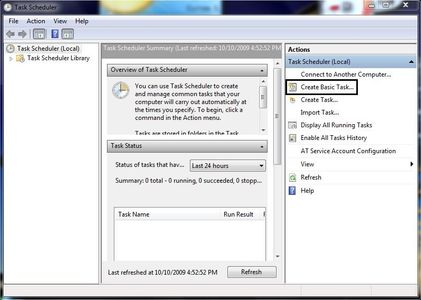

In Windows Vista or 7 search "task"; Task Scheduler should be at the top of the list. Open it. Click "create basic task". Type in the name you want to call it and a description if you like. Specify when you want it to start. Specify date, time, and recurrence. Choose an action (start a program). Browse for the batch file. At the end, view over it to make sure it is exactly what you want, and click finish. At the task manager main menu, you will have to refresh the list at the bottom for your new batch file to appear (this is optional, it will take affect either way). It is best for the computer to restart to take affect.

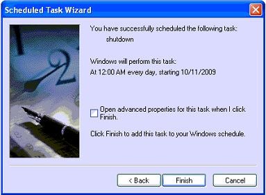

Step 3: Schedule It for XP and Older
For computers running XP and older, follow these steps. First, open Scheduled Tasks (all programs\accessories\system tools\scheduled tasks). Add Scheduled Task; a wizard comes up. Select the batch file. Choose the conditions under which this task will perform. Give specific date, time, and recurrence. If you use a password enter it. Finish it.

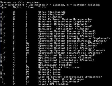

-d [p or u]:xx:yy reason; p indicates it is planned; u indicates it is user defined; xx and yy are
reason ID numbers (u:0:0 is easiest, it means other and unplanned)
All these functions also work in comand prompt (cmd). In cmd, you also do not have type the entire filepath.
Type shutdown in cmd and it will give a list of these variables. Note, not all operating systems will give a complete list, some may not give all the reason ID numbers, some may not have all the variables or may not support them, some may even simply shut down no matter what form of the shutdown command is put in the command line.
