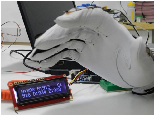

First of all, this project is not finished. We're still trying to improve and fix some problems. Right now, we're only able to translate letters from "A" to "E". The program still have problems while identificating those letters, the values for each of them match sometimes, so we're still trying to fix this.

Sew the five sensors to the glove. Make sure they're all fixed, but not too tight. The sensors should follow finger movement as much as possible.
After, solder 15cm stranded wire pieces to each of the sensor leads.
Remember to reinforce de pin-end of the sensor, this area is susceptible to kinking and eventual failure. Electrical tape ou heatshrink is fine.

The Arduino Analog/Digital Converter will assign a number for the input voltage. As it has 10-bit resolution, this number will be between 0 and 1023 (2^10). Actually, as the Voltage Divider output is inversely proportional to the resistance, this ADC output is somewhere between 780~805 when the sensor is straight.
Connect the respective VOUT's to Arduino's Analog Inputs, starting from the thumb, Analog input 5 to 1.
Step 3: Programming
During the research phase of this project, we soon noticed that there are considerable variations between each person's way of making the sign language signs. The software for our glove should, then, be able to adapt for such differences. Our solution was to implement an associative memory. With the associative memory, the user can "train" the glove to recognize the signs. The training is made by making the sign with the glove and telling the software which letter it represents. The software then stores this in a database and, every time the user makes a sign, it looks through the database for the best match. Using this solution, ou prototype is easily adaptable to each particular individual and to different sign languages.

The system actually ended up being pretty accurate, and the associative memory turned out to be a great solution.
Again, we're still working on the system, and we need your help. Anything you think would be a good add-on, improvement or fix.
