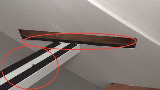

I cut the 2 cm strips in half (in length) and used this to make an insert into the wall side of the stair case.
In order to avoid wobbling I did the front and back of the support beam of each step. I could have done the center, however when the beams are not entirely flat, you risk causing a rocking step because of the transfer of the shape of the beam (though I didn't test this theory myself).
To be clear, I added an additional picture with the red circles around the added EPDM strips.
