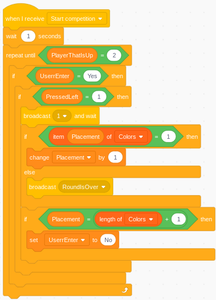

This part of the code is inside the backdrop and possibly the most complicated part of the program. This program interacts with the lists, broadcasts which color is up next, senses if the list is empty, changes the score, and determines when the code is playing and when the user is making an input. The backdrop is also the background of the game.
  1. Choosing the backdrop. Select “choose a backdrop” and select “Galaxy”. Make sure the galaxy is the backdrop you see.
  2. Due to the difficulty of the code it is best to use the image provided to copy the code. The score functions in this code reset the score (the -1 is needed), and everytime the user gets the combination correct, the score increases by 1. The repeat until allows the program to repeat until it is the next player's turn. The if “Chosen colors” > 0 sees if there are any more numbers left that the player has not yet used. There almost always is, and so the first number of “Chosen colors” is moved to “Colors” before being deleted from “Chosen colors”. In the event that there are no more numbers left that the player has not used, the message (new message) ”ChosenColorsIsEmpty” will be broadcasted and this script stopped. The variable “Smile” is both a reminder to smile, and is used to read back all of the items inside of “color” and broadcast them in order. After the broadcasts are complete, the variable “Userrenter” will be changed to yes to allow the user to input their response. The code will then wait until “Userrenter” is changed to no from a different part of the program.
  3. Duplication and replacing. Duplicate the last code 4 times. The next step is changing which lists are interacted with. Choose one of the duplicated scripts and replace all of the places with “Chosen colors” to “Chosen colors #2”, everywhere with “Colors” to “Colors #2” and message “Start competition” to message “Player#2Turn”. Choose the second of the duplicated scripts and replace all of the places with “Chosen colors” to “Chosen colors #3”, everywhere with “Colors” to “Colors #3” and and message “Start competition” to message “Player#3Turn”. Then finally take the final duplicated scripts and replace all of the places with “Chosen colors” to “Chosen colors #4”, everywhere with “Colors” to “Colors #4”, and message “Start competition” to message “Player#4Turn”. The visable replacements can be sceen in the boxed-in parts of the image.

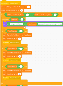

  1. If the Hippo receives the message “ChosenColorsIsEmpty”, say “All the colors imputed have been completed!” for 5 seconds and broadcast “RoundIsOver”
  2. When the Hippo receives the message “Game Over!” they will say “Game Over!” forever and other scripts in the code will stop.
  3. This script will be in two parts because it is essentially made up of two separate circumstances. This code is triggered when the broadcast “RoundIsOver” is received. The variable “#OfPlayersStillNeedingToGo” is changed by -1 to signify the amount of players who haven't gone yet. The variable “PlayerThatIsUp” is changed by 1 to signify which player is now up. The if statement then detects if the number of players still needing to go is equal or greater than 1. If there is no one left to go, the code will run the If Else section which will be coded after this part. But if there are still 1 or more players remaining, then the Hippo will say “Attempt over! Player #” variable “PlayerThatIsUp” “ you are up! Press space when you are ready.” This tells the players whose turn it is now until that player is ready and they press the Space Key. The next If Statement will sense whose turn it is using the variable “PlayerThatIsUp” and will update the variables that represent the final score of the last player who went. After the score is saved, the visible score resets and the broadcast will allow the next player to start playing. Depending on which player is up, the code will broadcast either “Player#2Turn”, “Player#3Turn”, or “Player#4Turn”.
  4. The second part is for what happens when every player has gone. The main purpose of this code is to display the final score for the player/players. This code allows you to show the final scores of all the players as well as update the final score for the last player that went. Use the image provided for the different variables:
